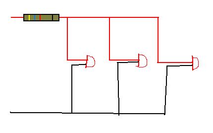

ok, another question. on the actual wiring of the leds, to save room, and get more leds, why couldnt one wire it like this:
You can. I've done it more than once. And I found it doesn't effect the brightness also
i see... i mean, that way, you could get mor led's in one space, because your not competing with all the resistors, right? is there a drawback to doin it that way opposed to the conventional way?(one led per resistor)
I think you'd need a different resistor.
hmm, what resistor do you think i need? (by the way, i havent gotten them yet, im just planning ahead. i could always just experiment :rolleyes:
I used 470 ohm resistors. That was one per LED.
