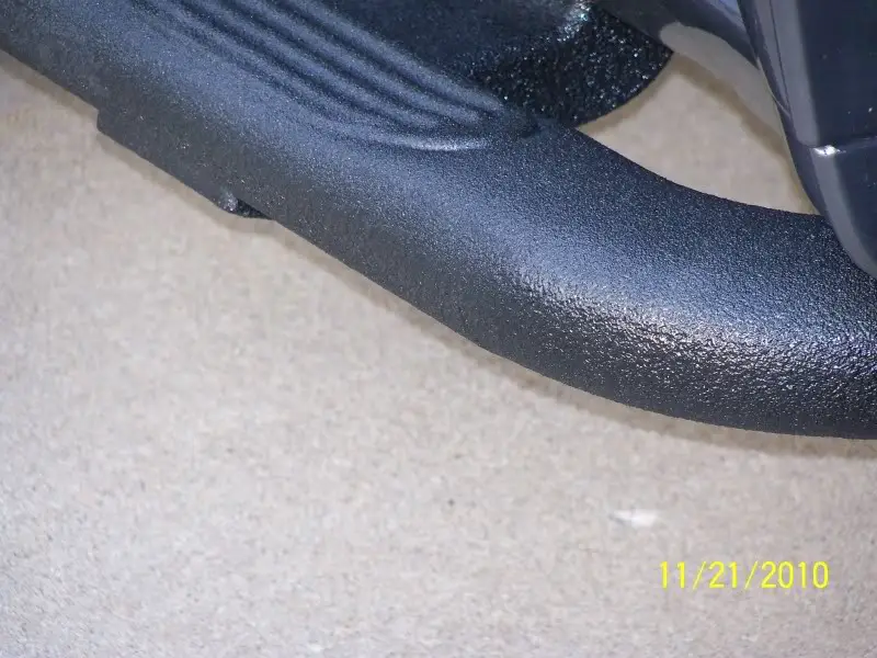

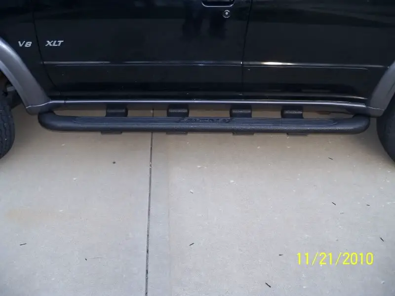

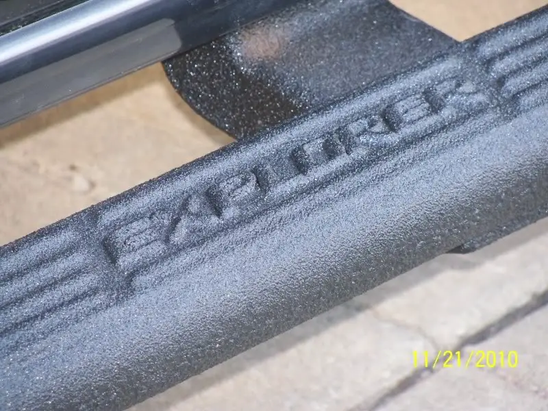

My X's step bars were looking pretty ratty with rust developing around the end caps and stuff. I decided to kill 2 birds with one stone. I removed the bars and took them to my cousin who own an Ameriguard bed liner location and he applied a nice lining to them at no charge. I think they turned out great.

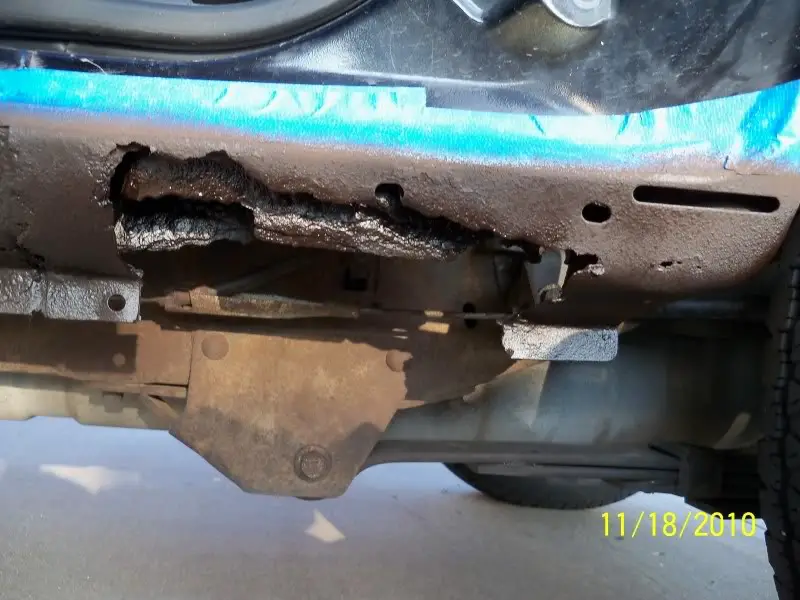

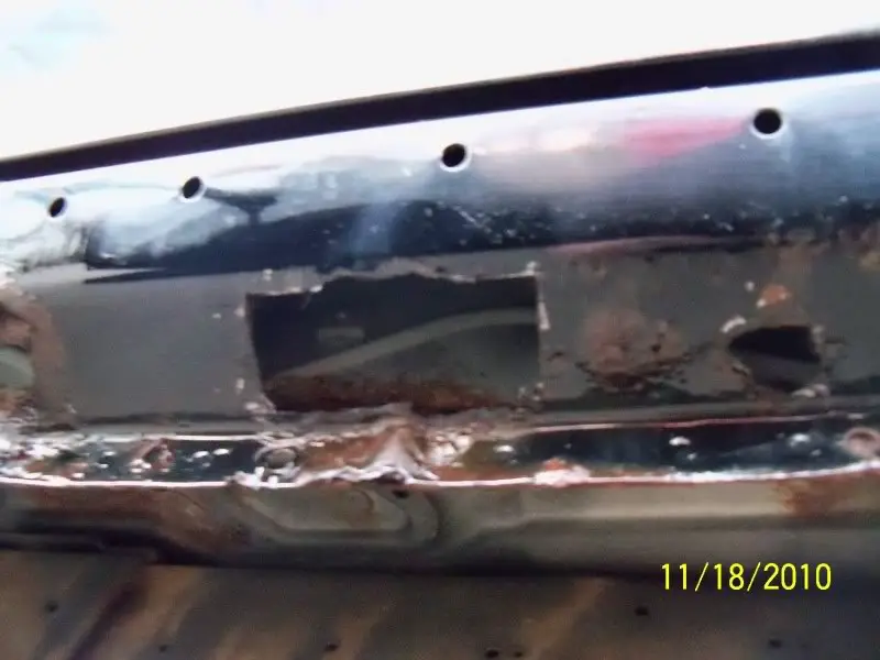

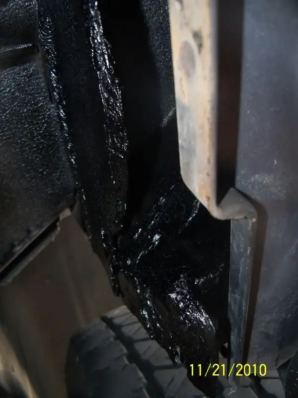

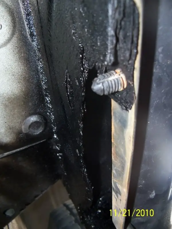

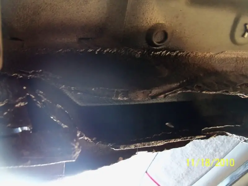

While I waited for the step bars to be done, I decided to see what the rockers look like under the plastic trim. I thought it wasn't that bad until I started digging around. The rust was pretty bad. I cut out most of the actual rust and then applied a rust treatment. I then applied a couple thick layers of undercoat and then a final layer of Ford black before reinstalling the plastic rocker covers. I was very pleased with the end results. What do you guys think?
Before
Half done...
Undercoat applied and ready for paint...
Finished
This looks worse in pics than in person

Before
Half done...
Finished
