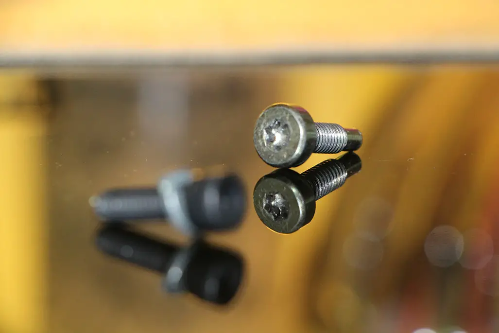

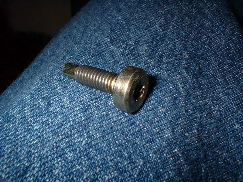

Update*** After about 6 months the shifter got real sloppy, so I removed the lower covers, and inspected it, both had began to loosen agian, and I was able to turn them by hand. So this time I took them out, and put a drop or two of the blue locktite, so hopefully that will prevent them from coming loose again, update again in another 6 months or so. I think I have more of an issue then other due to my stereo, so this shouldn't happen to most people in as little as 6 months.
