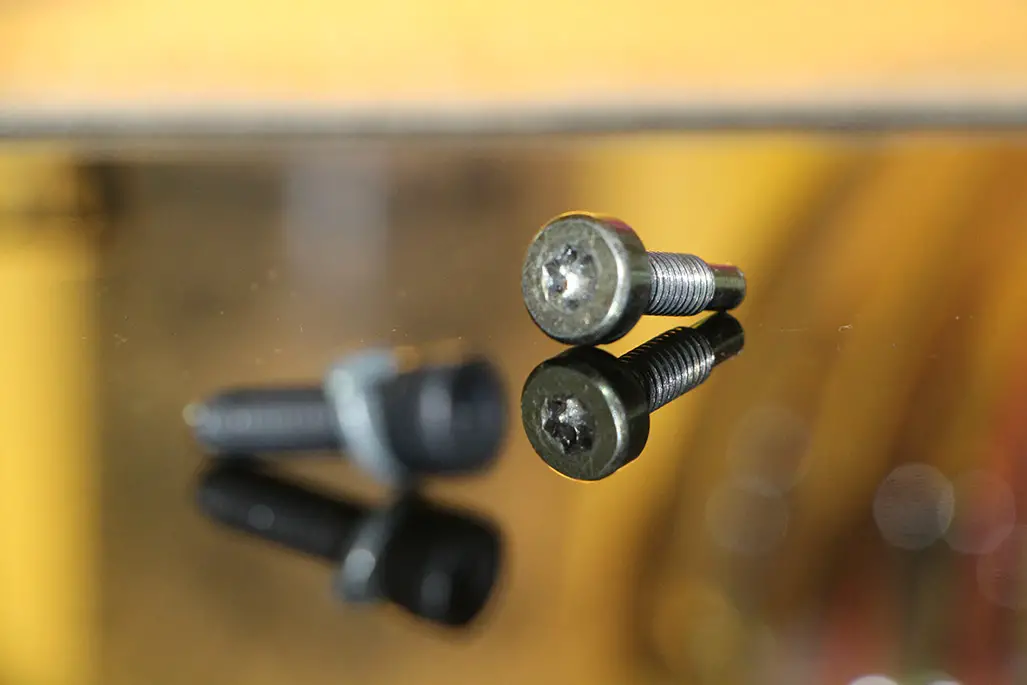

i tightened my bolts down a couple years ago (including using locktite) but they loosened up again it was time to do the job over. however, when i looked, i found that one of them was totally missing. i have other cars, so i was able to take the remaining one down to the hardware store to match, but that might be difficult for those of you who only have the one explorer/mountaineer. so since it's not already listed elsewhere in this thread, for anybody else:
The bolts are M6x1.0 x 20mm. If you get it in a cap head screw, it uses the same T30 driver as the OEM ones (convenient) or an allen key. I replaced them both so they would match.
Ford probably should have used bolts with captive lock washers from the factory. I added lock washers this time, and between them and locktite blue, I really doubt I will have to do this job again. Total cost: 85 cents.
Everybody likes pics
Old and busted:
New Hotness:

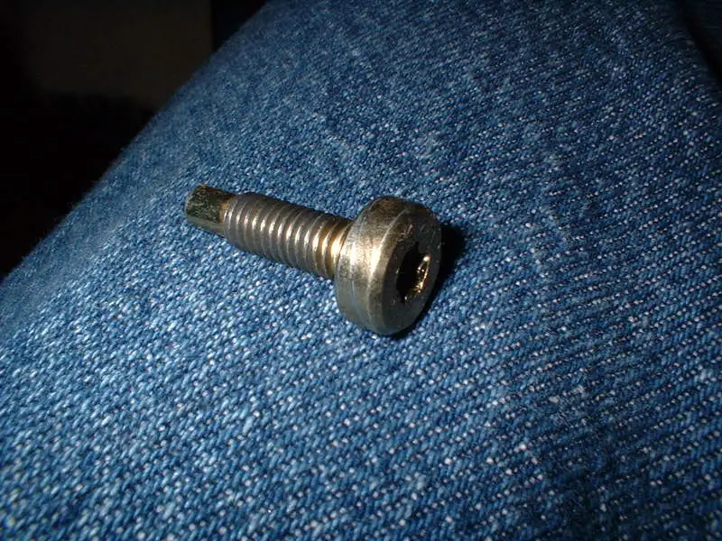

I have a 2003 ford explorer and i just found that bolt on floor..Quick story: I was driving home last night with my stereo up loud (it shakes the dash a lot) and a bolt fell from under the dash onto my foot. Today the shift lever for the transmission has a lot of free play and doesn't want to go all the way into "Park" and the needle doesn't line up with any of the letterers on the dash. I have to pull the lever towards me to get it to move down into "Drive" (actually OD). So, does anyone recognize this bolt as something that would cause my problems if it fell out? Or is this strictly co-incidental? The bolt is about an inch long.

Looks like you need to crawl under the dash and find the empty hole next to the other gold bolt.I have a 2003 ford explorer and i just found that bolt on floor..
