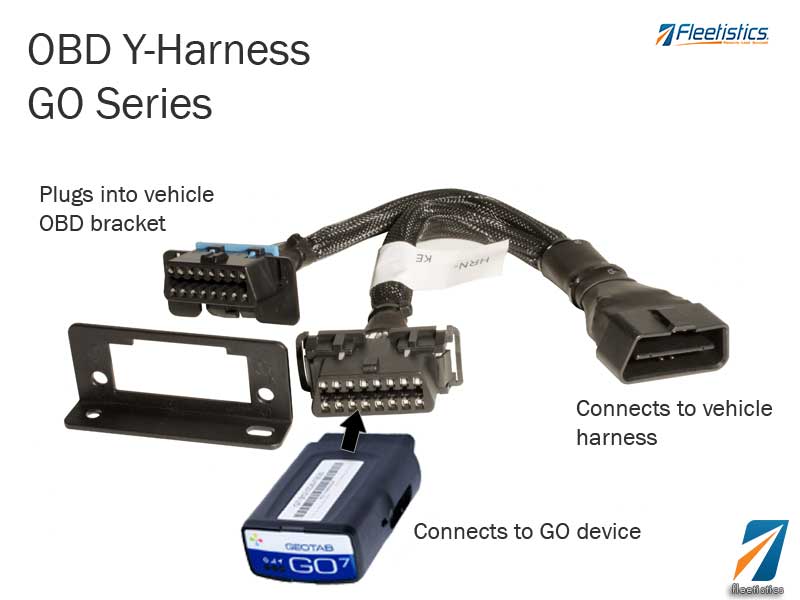

That doesn't look like an OEM OBD port. You may have something like the below on your vehicle. Only you or someone in the vehicle will be able to poke around and find it. You need to get under the dash and have a look around. If it has GPS, it should be mounted as high as possible, so you may really have to look around.
Fleet Tracker OBD
Optional Driver Behavior Buzzer Included. If you wish to use this feature, we can configure the device to trigger buzzer alert when speeding, excessive idling, rapid acceleration, deceleration, or hard cornering. A high pitched continuous audible “beep-beep” alerts the driver whenever they are exceeding thresholds mandated and set by their supervisor. This feature by default is off, but we can turn it on at no additional charge.
For those vehicles, where the OBD port is in an intrusive location, we have available a splitter cable,which allows you to install the gps tracker in a more covert fashion.
