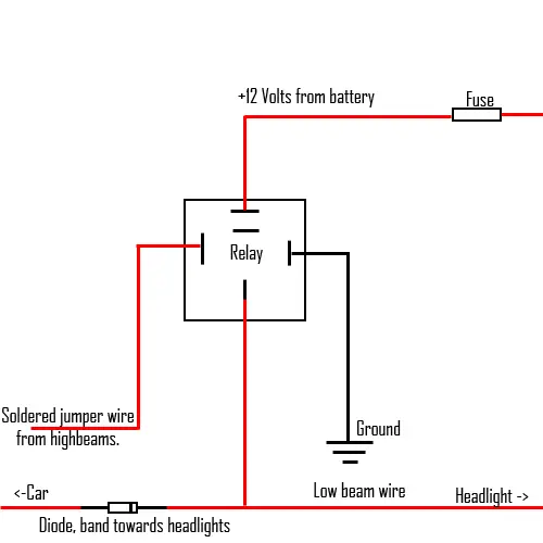

Here's a kinda detailed diagram. You diode isolate the low beam wire to prevent back feeding voltage. Make sure the band is facing towards the headlights, it allows voltage to go to the headlight, but not back into the switch/relay, whatever is back there. Made it kinda big so everything wasn't squished together.
I still think relays would be much safer.

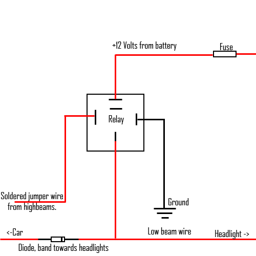

Thats a really good illustration, but where does the diode connect to on the car? I think this solution would be much easier to do, and cleaner.
That looks like it will work, I was thinking that they were talking about inserting a diode in parallel off of the high beam wire and onto the low beam, so when the highs were switched on, they would power both lights from the one wire, which wouldn't be a good idea.
Using both a relay and a diode like you have done is the best way, however the diode is probably not needed(but is a good idea to be safe).
I would throw it in to be safe. I don;t like to have back feediing voltage ( even though I'm sure it'll be ok). It's cheap enough anyways. Jumping the wire would work. But as someone saw, it blows the fuse drawing too much current. In order to do that you'd have to beef up the wires. And that's more work than just doing this obviously. lol

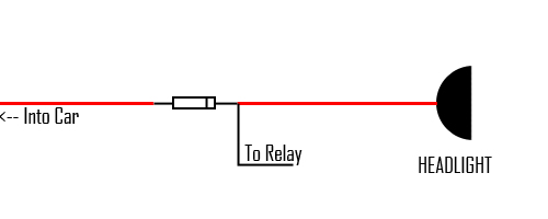

Dan
You cut the low beam wire and place it in, and on the headlight side of the diode splice in your wire to the relay.
Cheap, quick little diagram, with a sad-looking headlight, lol. It's the low beam wire.
