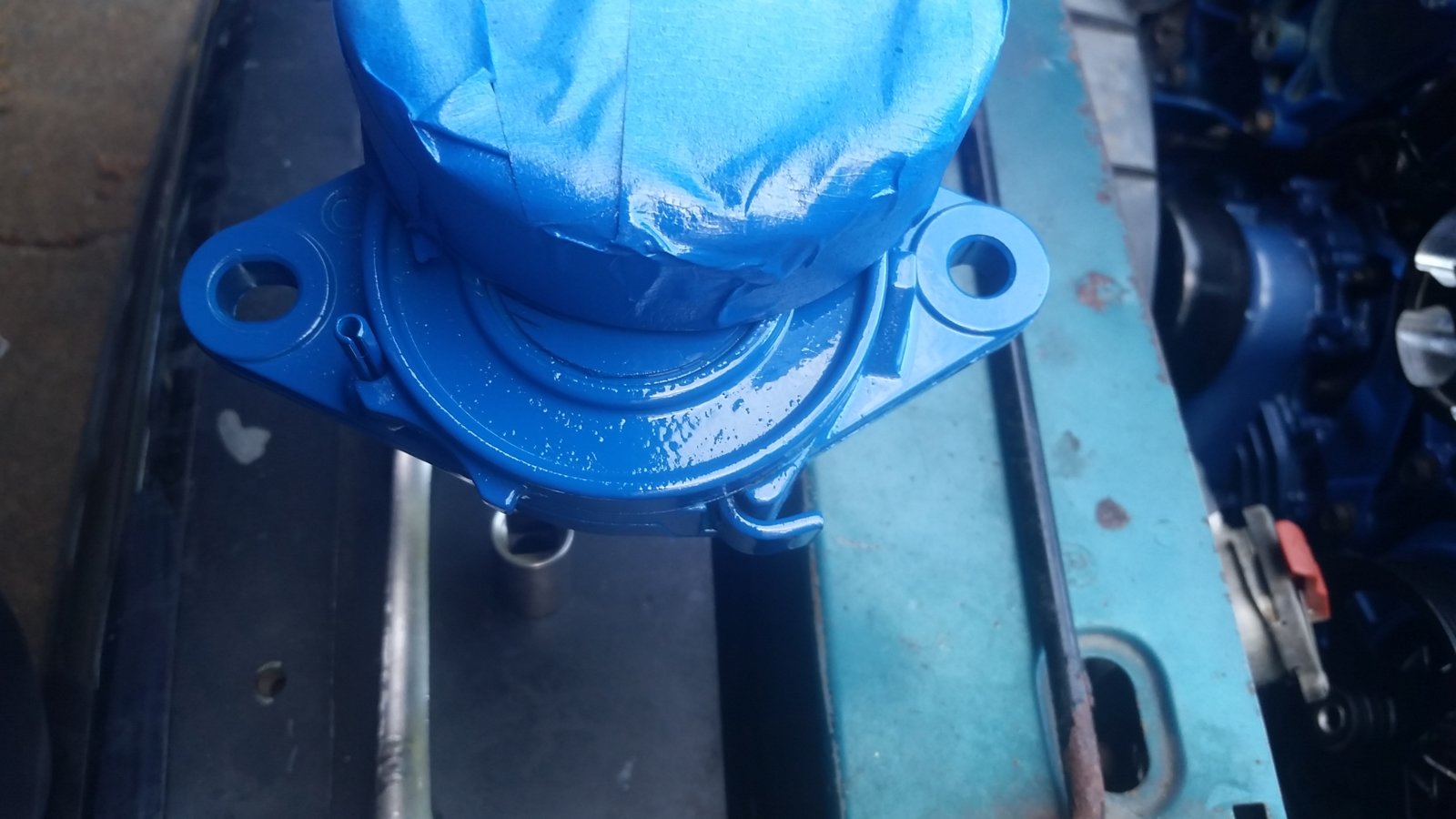

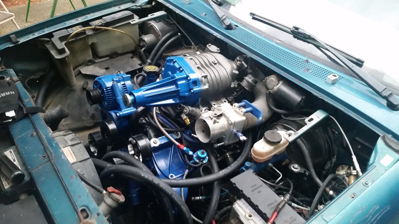

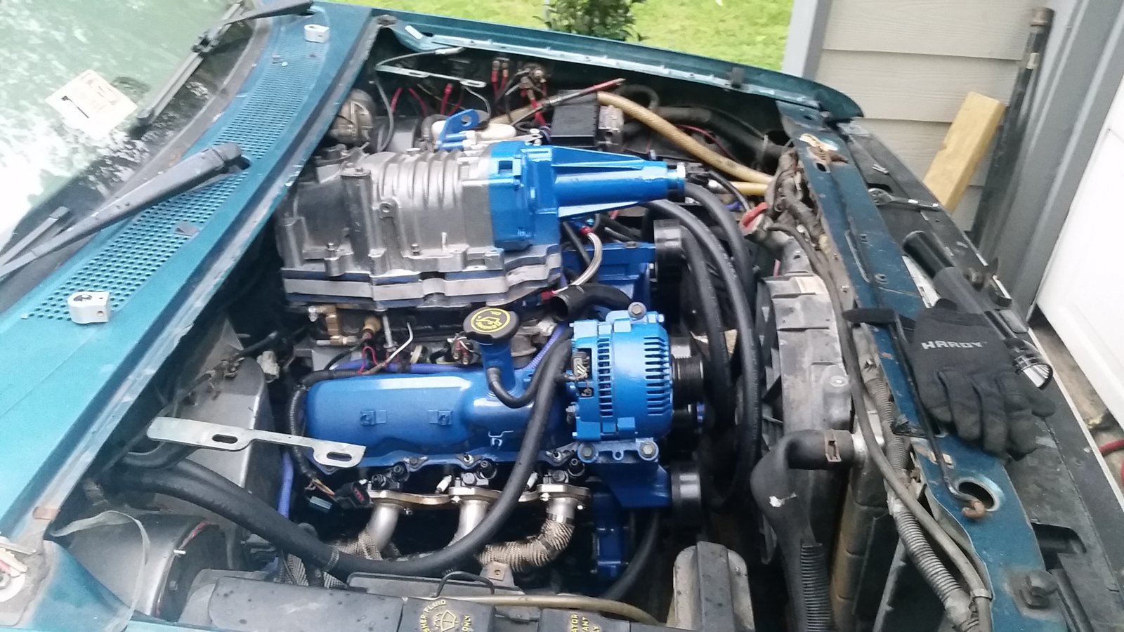

i had to take it back off though to mill the snout for the 2.5 pulley and too add oil which i forgot at the storage unit. .but it clears and the hood shuts....calling it a day,going to swing by Wednesday and try to get the supercharger on for final time,measure for a belt,throw the driveshaft in and hopefully get it fired off by the weekend.HOPEFULLY! !

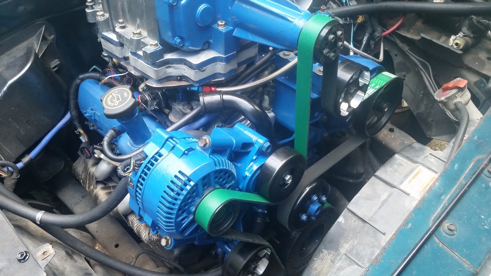

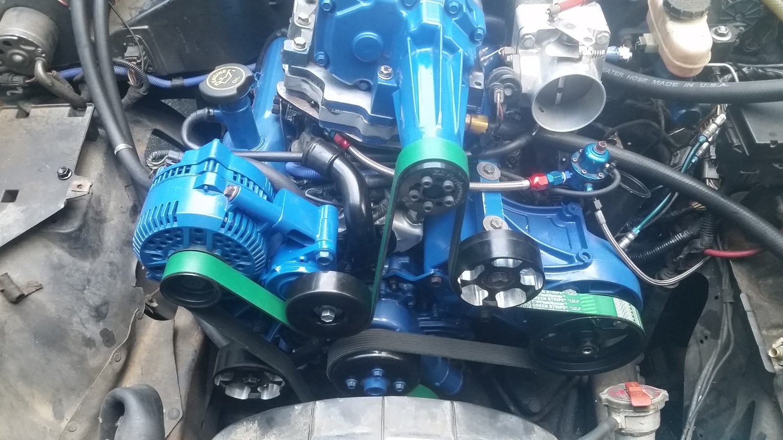

Supercharger is on for final time..also figured out the belt,its 101" 8 rib...i need to find out how gates does their part numbers for the green or blue belts...anyone know?? The belt i found that fit in stock was a duralast and was 101.3" 7rib and it was tight..

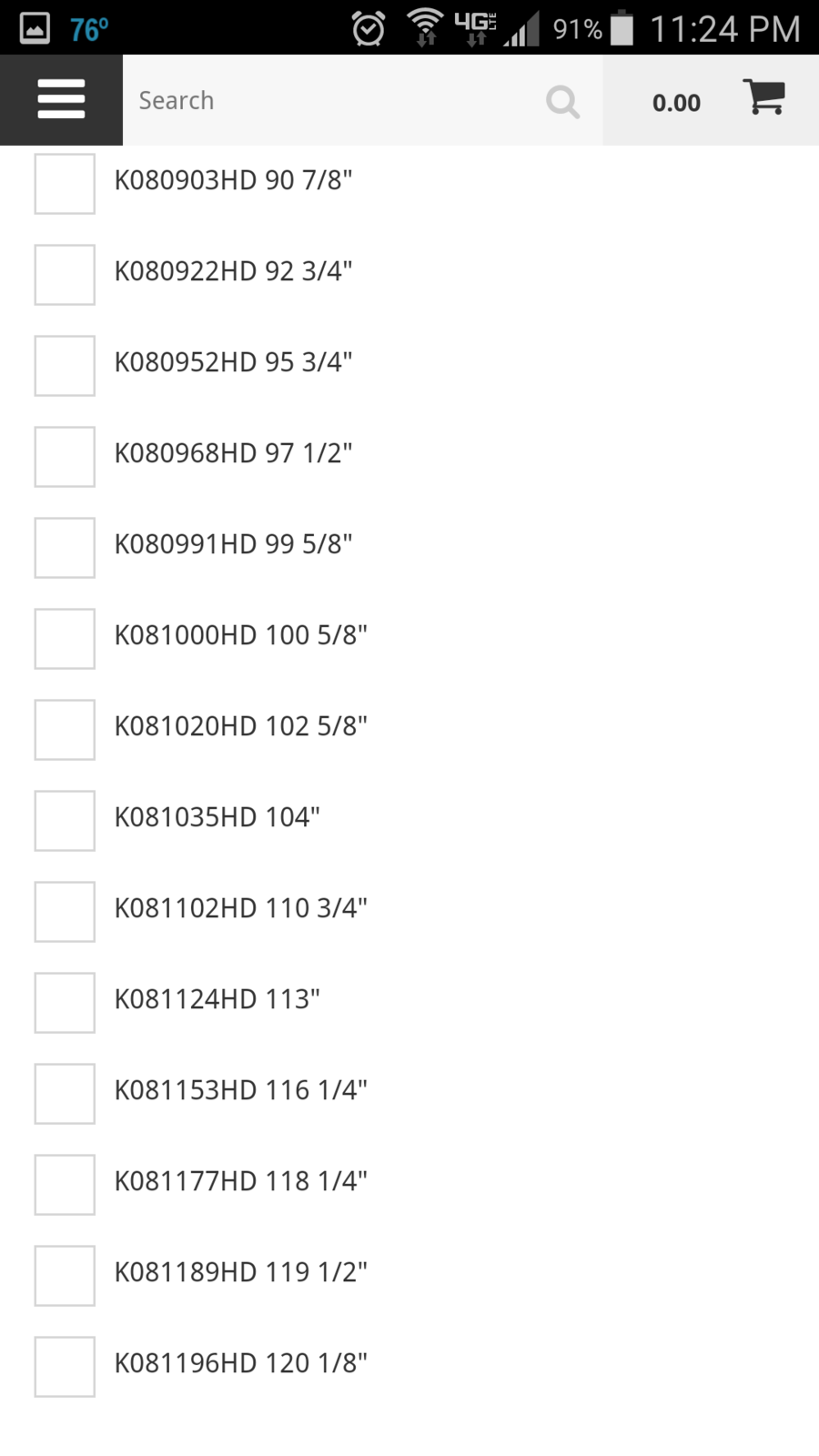

K081000HD is the gates green belt part # and is 100 5/8" long..next would be k081020HD and its 102 15/8" long,think thats going to be too long..
Smaller or bigger idler somewhere? The 5.4 8 rib tensioner pulley will be one of the smallest off the shelf pulleys you can get.

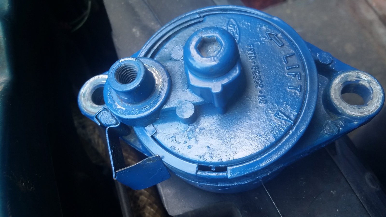

I honestly think the 100 5/8" will work,we will see today. .they had it in stock.ive got all those nice expensive metco idlers on there now and hate to get ride of one..lol.also bought a new tensioner, mine the little spring clip broke that stops it from tensioning too far
It fits..its going to ""break in"" a little too im sure. .also the new tensioner is a much much better design. .
Just sexy..probably first 8 rib OHV out!!
The stops are cast into the mount itself on this one and the spring is much thicker and clips through the body..
Can see the "spring" is bent that stops it from going to far,also the tension spring is internal. .this one was definitely shot..

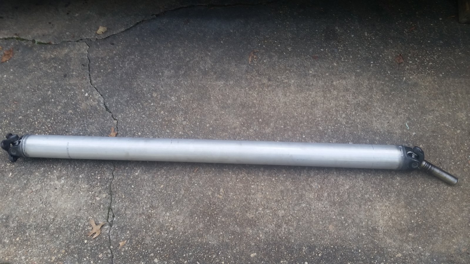

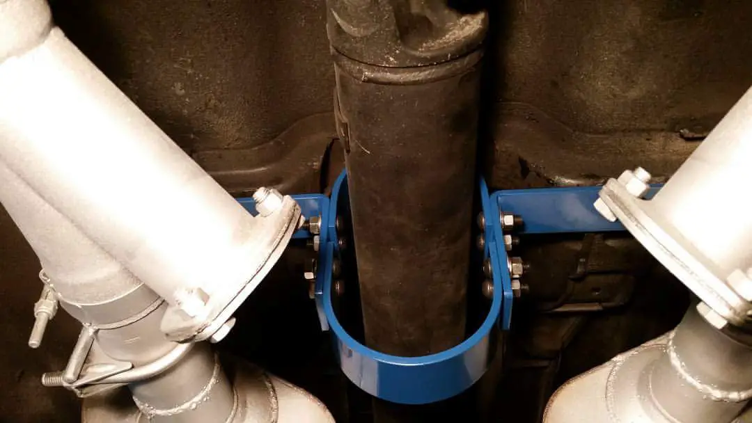

New driveshaft 1" shorter fits fine,it wouldve probably cleared without being shorter but fits fine now..really wished i went with a 3.5" tube but at $180 more and 7-10 days out,it just wasn't gonna work..should be fine now the trans is solid mounted, its still very very very close to the bolts in the driveshaft hoop!! Like 1/4" close...
Here is older picture of hoop to show how close it is....

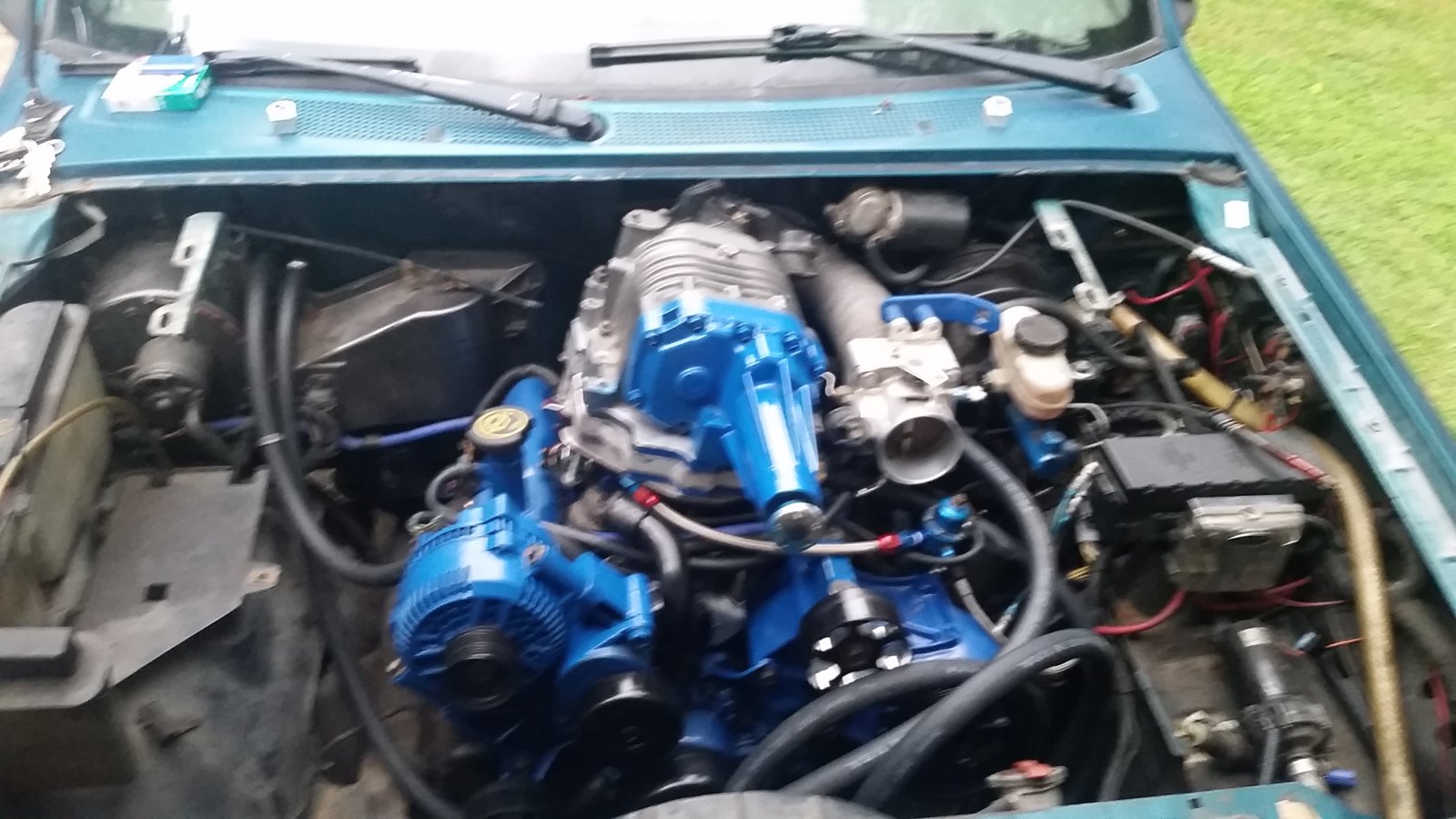

It fired right up but you can hear the belt jumping ribs..then can hear the starter getting stuck..or least thats what i gathered from it..this was the very first start..
