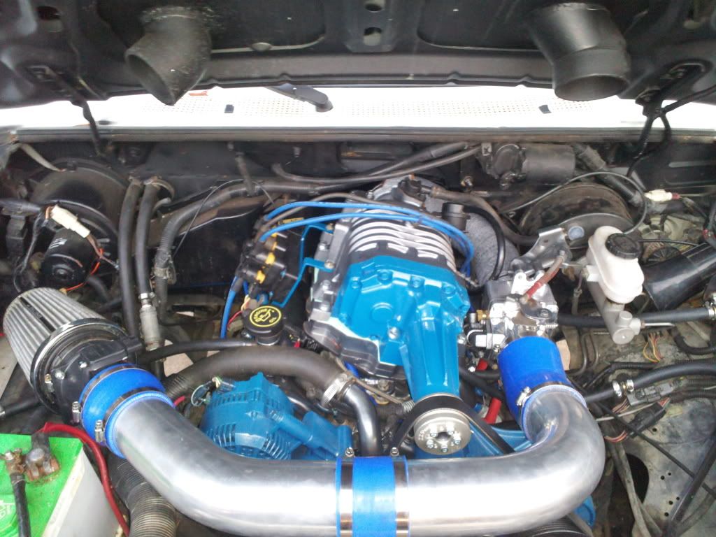

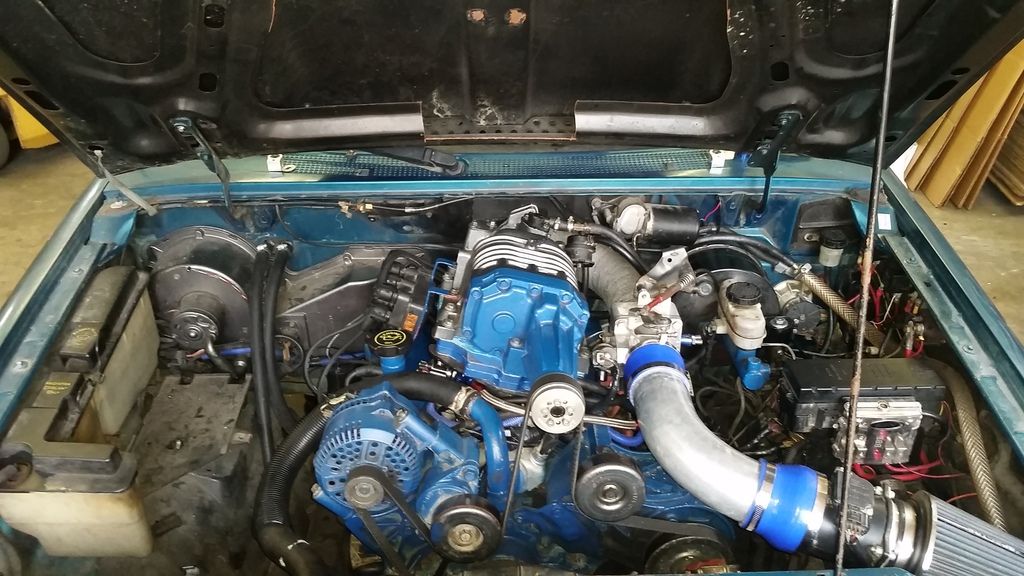

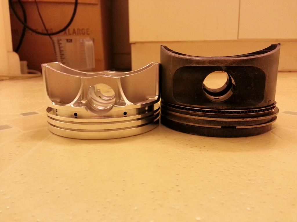

new motor specs
BORE: 4" JE asymmetrical pistons (custom over bore)
RODS: 6.058 Manley (longer rod)
VALVES: IN-1.8 EX-1.5 Manley heavy duty (.150 over)
Transmission:T5 hybrid from a 2006 Mustang and 93 Fox

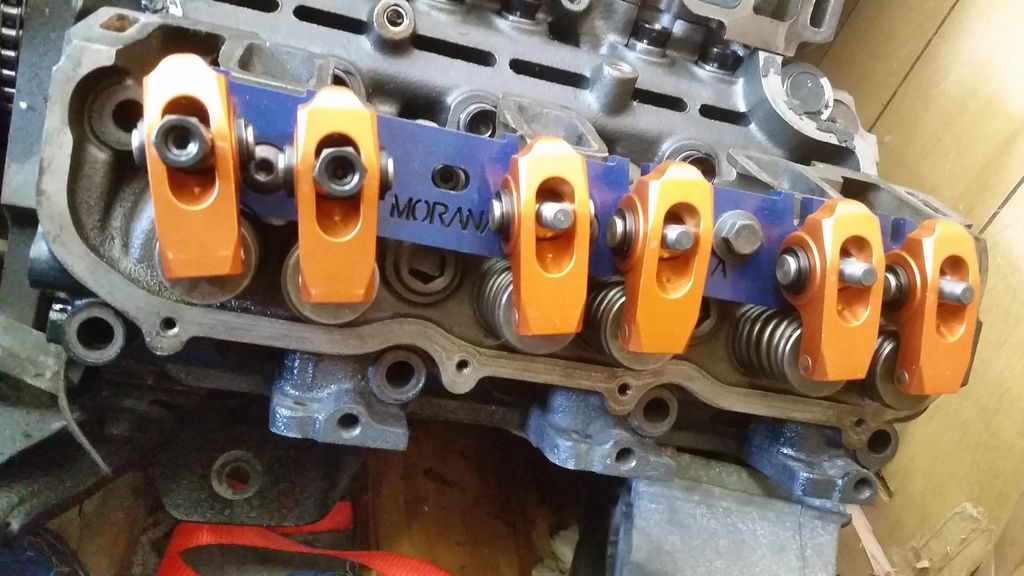

HEADS: 93TM HEAVILY ported with custom brass guides and copper gaskets/O-ringed with ARP studs
CAM: 422 Comp cams with 988 springs and Toms custom lifters,push rods and 1.7 roller rockers
Complete blueprint and balanced internals
GM M90 supercharged with one 1" intercooler plates with ASP 8 rib belt conversion. .
pushing 16 lbs of boost with small shot of NOS
Running on E50
Dyno tuned by Dyno Tune Performance outa Virginia using SCT
old thread and pic

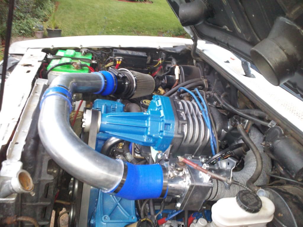

3800 M90 Build
ported and polished gm 3800 gen 2 m90
Water to air intercooled
port matched 76mm inlet and intake tube
mustang 75mm race tb
90mm maf
36lb injectors
255 fuel pump
sct 5bank dyno tuned
2.7" pulley 10lbs of boost!!;)

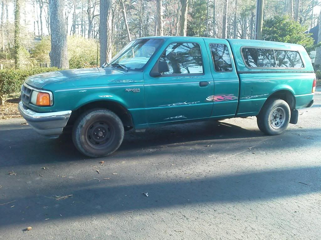

and the new 1994 ranger 4.0 OHV 5 speed 2WD with 115,000 miles on it.o and i only paid $1,000 for it:shifty_ey
RUDY
the very first thing i did was make a intake out of some spare pipe i had laying around and took the cap off.the intake is just temporary but shows my mind set;)also traded xeek my 33s i had for his rims and hes gonna make me a custom headliner:D

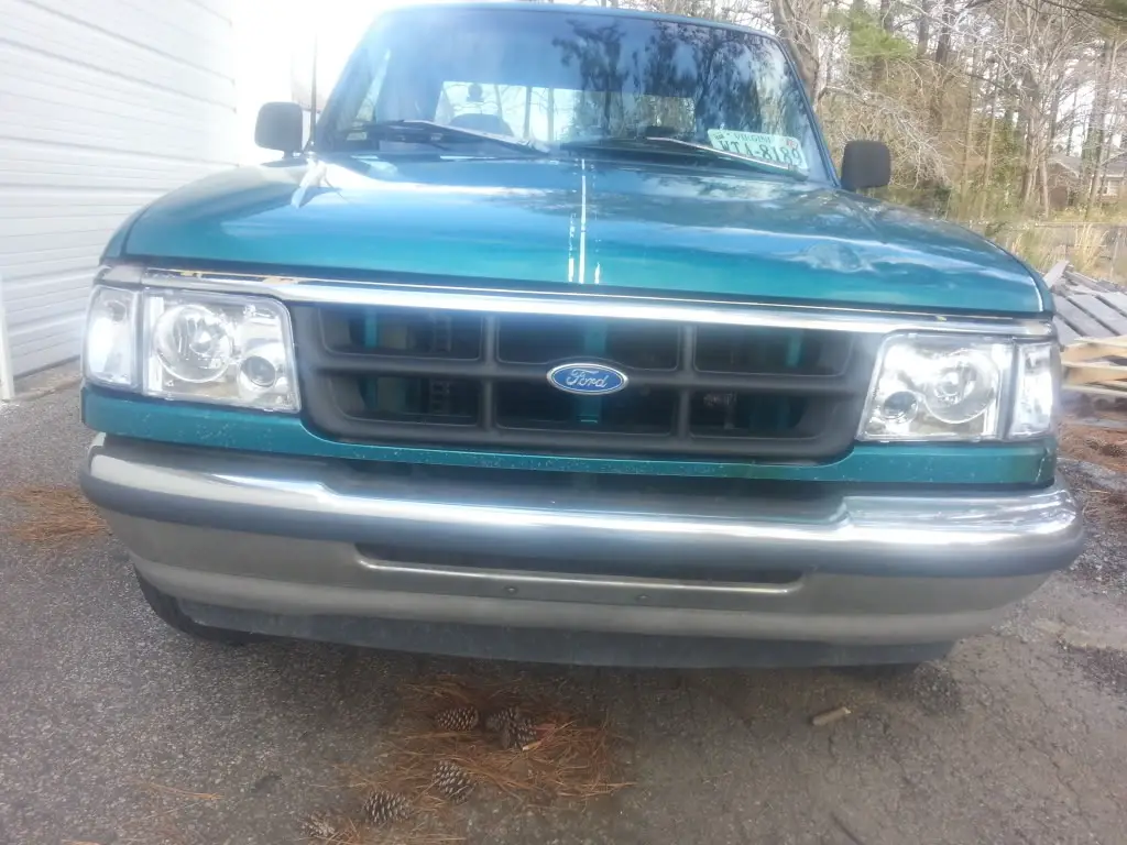

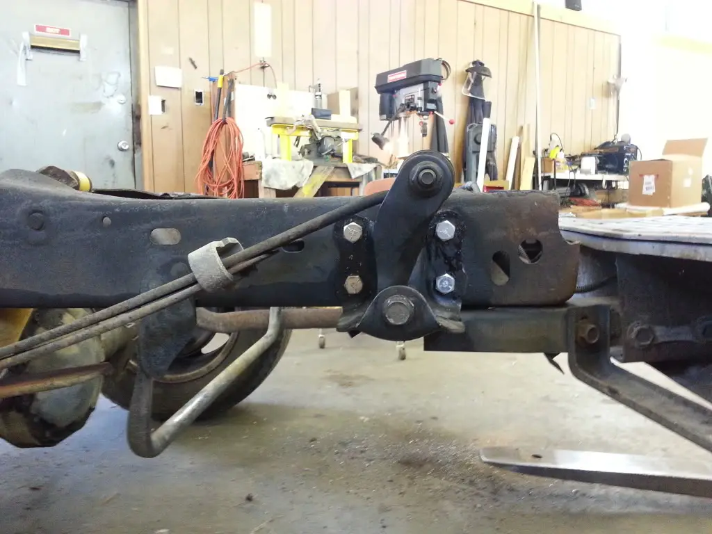

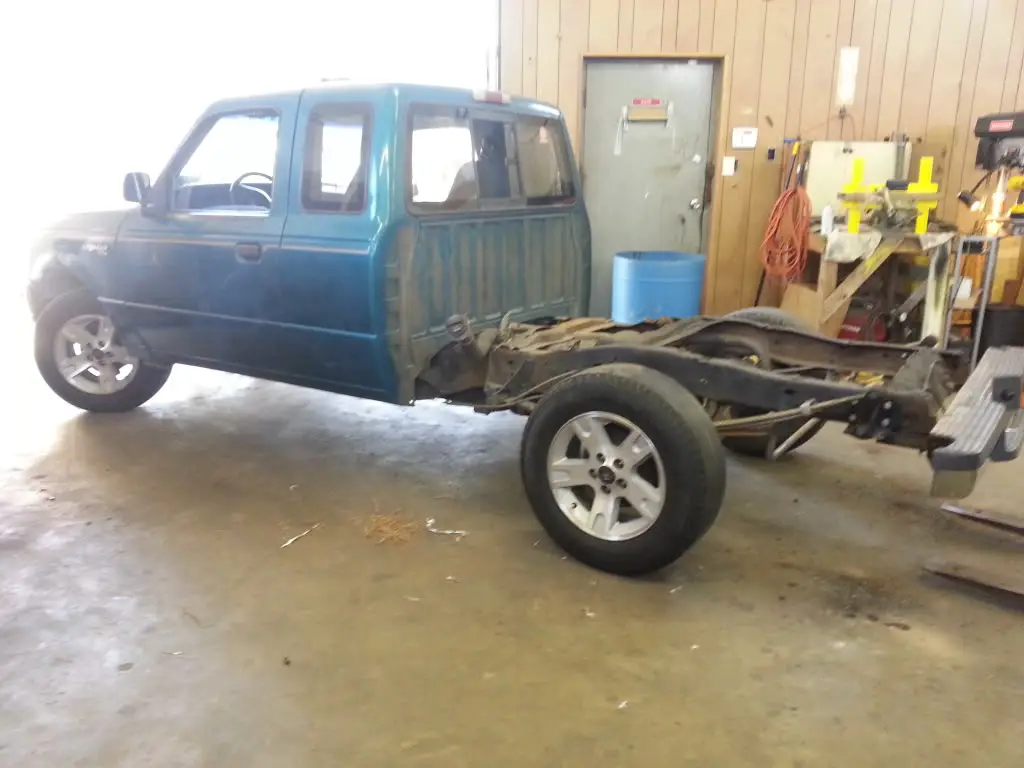

next i got ride of those dumb ass stickers.there was 28 of them on the truck and the ones up top,the glue baked into the paint and wont come out but looks 100% better.i also did a shackle flip in the rear to try and level it out some.it will be getting an 5.0 explorer 8.8 3.73 with an extra clutch and sua.should give me around 5-6 inches of drop.im getting dream beams for the front for 3 inches of drop.also doing the 95 spindle and brake upgrade.also mounted a new set of headligts.
dropped 2" in the rear

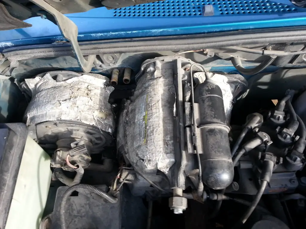

toady i did get some goodies tho.i went to pick and pull and got my no ac heater box and also got my 95 spindles.im going to be making a bracket that will alow me to the ST 12" rotors instead of the stock 10.25" over on rps they were making these brackets but stopped.if i can turn them out cheap i may end up making them for sell.here is a link to the thread and some pics of my new finds:D

before
after,still shocking how much more room it gives

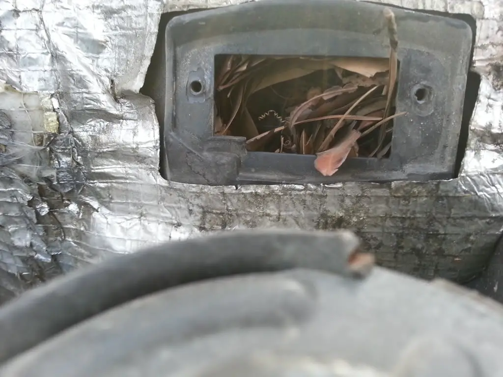

o and had a nest in my old ac box
Good thing you didn't turn the heater on.... that could've been very bad.
Oo forgot to even tell that part...yea I was out on a date picking up this chic for the first time..yea got chilly so turned on the heat.boooommmm the heater core blows up and fogs my whole truck out!!!:mad: I had to pull over and wipe the windshield off.made it to the bar and had to put water in it to get her back home.....hahaha the whole reason I went to the junk yard for that box.in the pics I hadn't had time to replace the core so I just took one hose off and conected the other to the pump (closed loop)

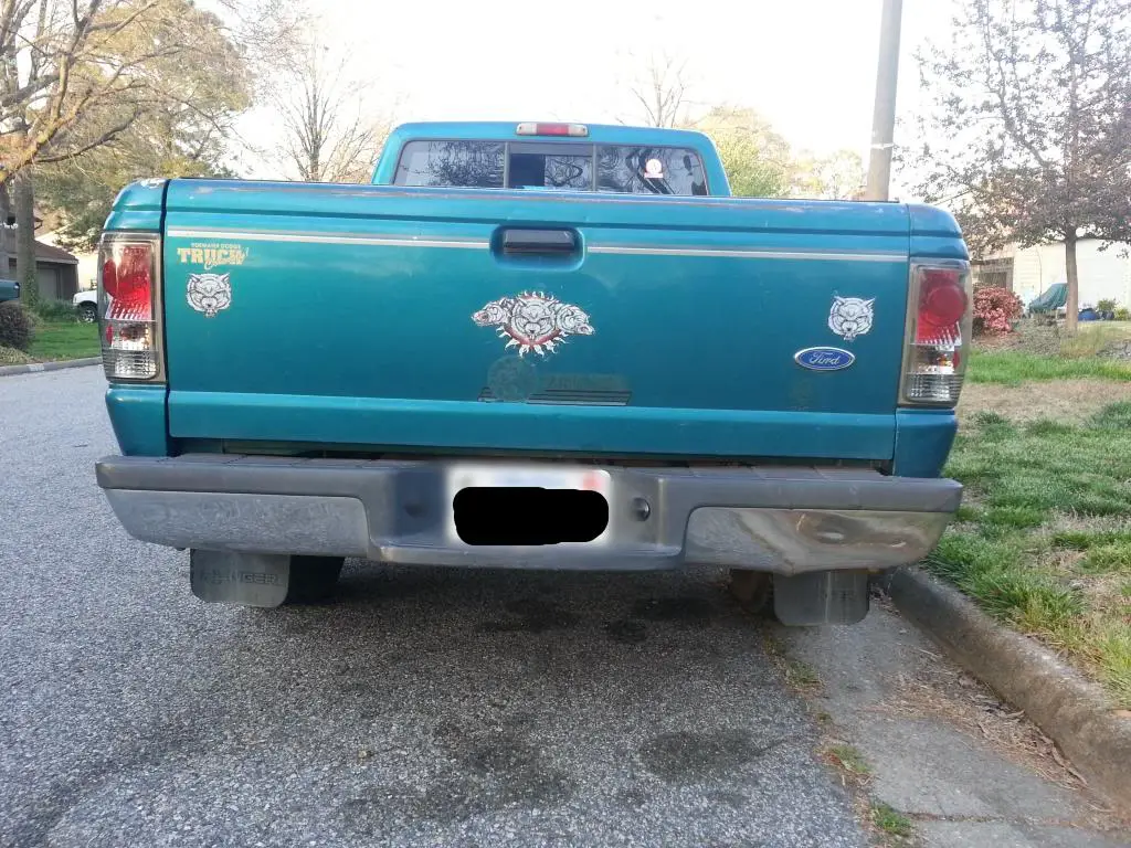

this is going to be alot of pics.starters i got a new set of tail lights put in and they look alittle more ricer than they did online but think they are alright.

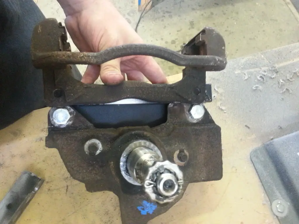

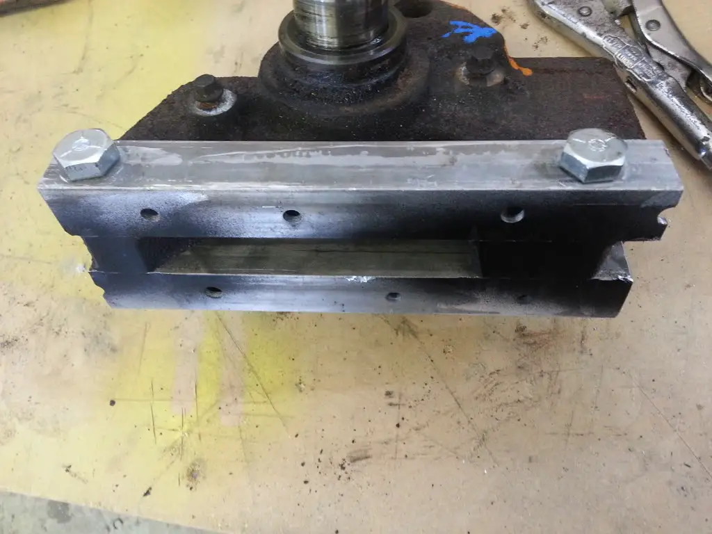

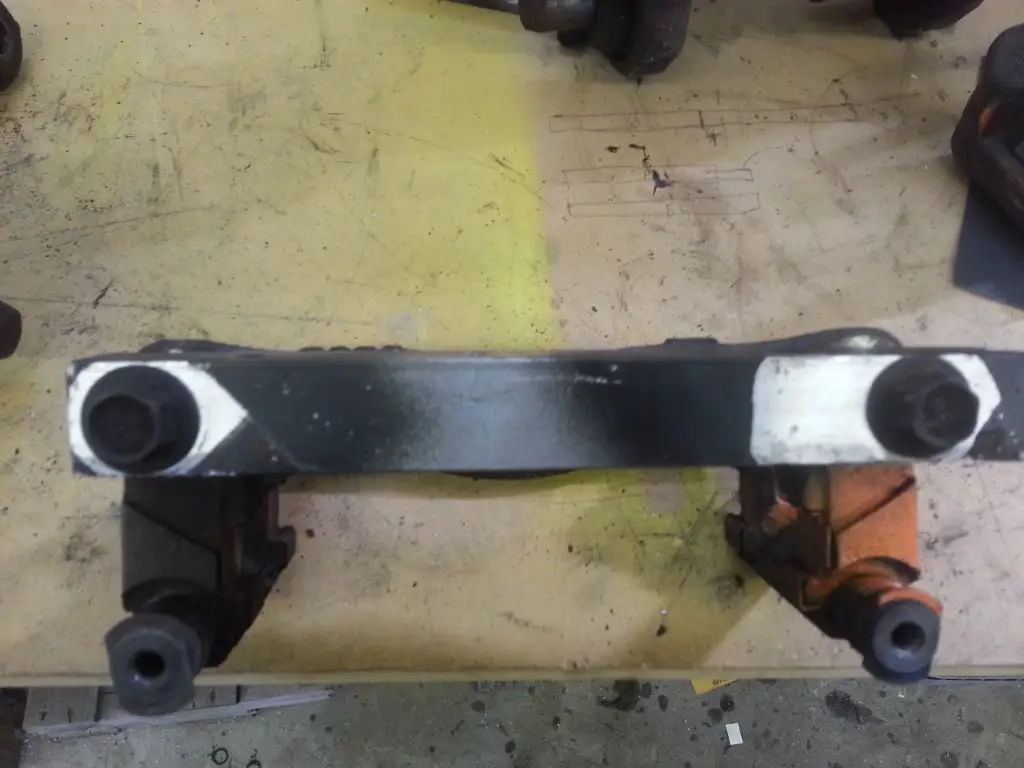

next i got all the measurements and mock up done on the ST 12" rotor swap.i ordered some fresh metal and as soon as it gets in im going to machine all the parts and weld them up.so right now im waiting on parts and the ST rotors to come in.ill show what has to be done and the final bracket,but dont think ill be releasing the measurements or cad drawings.i may end up selling these as a big break kit,so ill show what needs to be done and if you wanna make them your self your have to do the math;)
lights

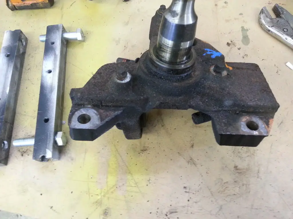

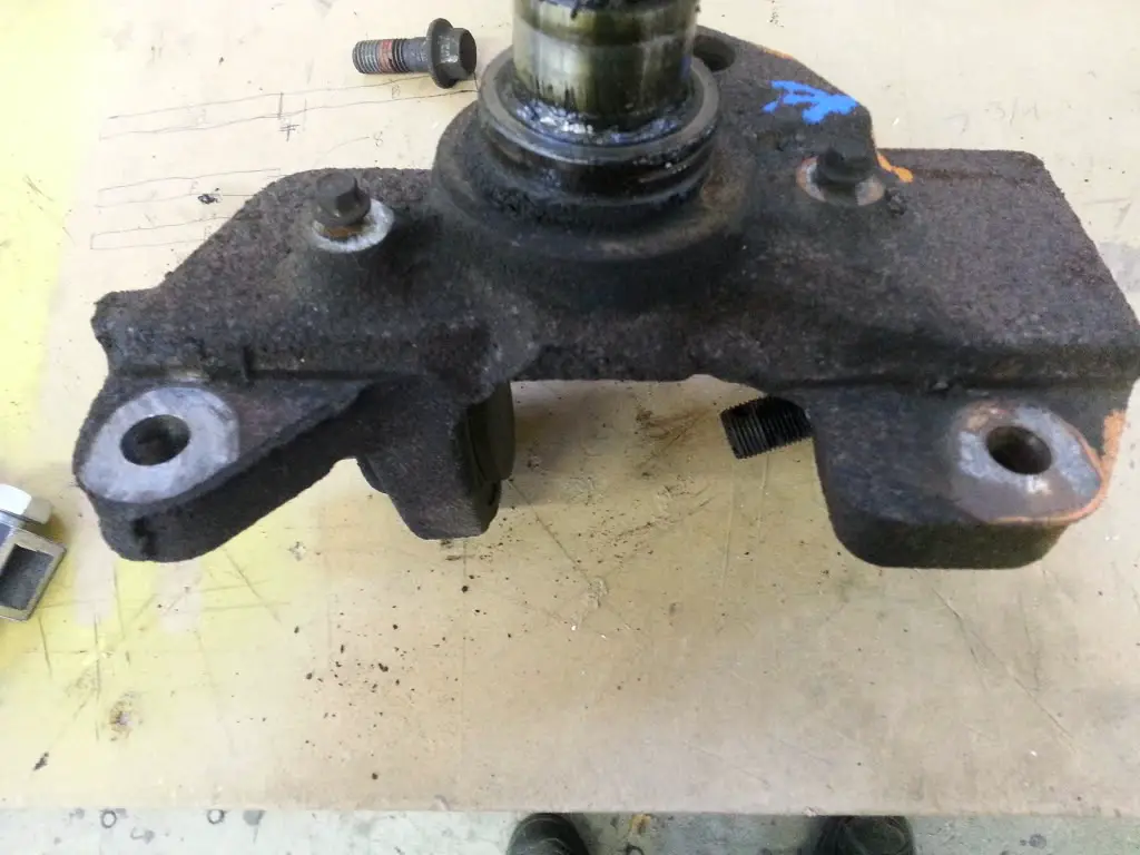

LOTS of pics for you and when the bracket is done ill show that,these are mock up with scrap i had around the shop so i could pull measurements.these are the 95-97 spindle upgrade so you have to have 95-97 or this spindle upgrade on your truck to begin with
stock 10.25'' rotors
mod for ST 12" rotors.(just mock up,not actual bracket)

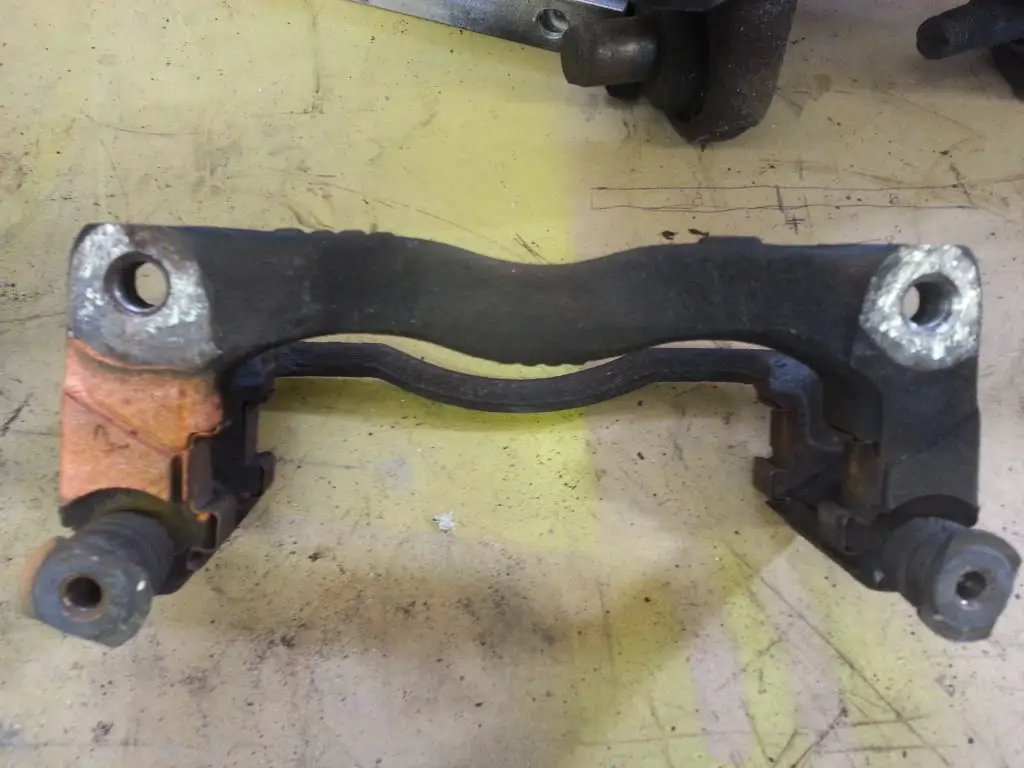

and now bunch of pics to show what was done,basically the spindle and caliper brackets have to be ground or milled down,squared up and the bracket holes need to come up..
spindle
caliper bracket

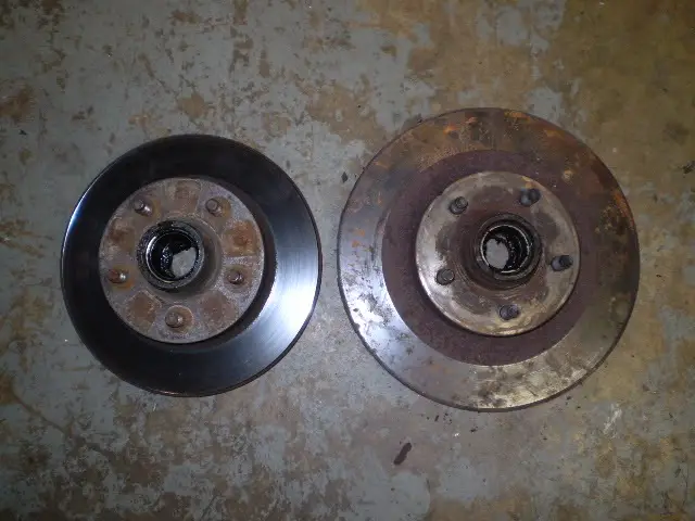

and a comparison of the rotors.not my pic but just a visual for now
