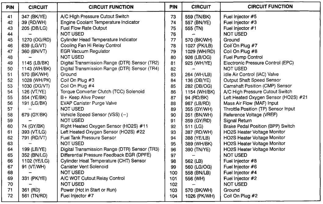

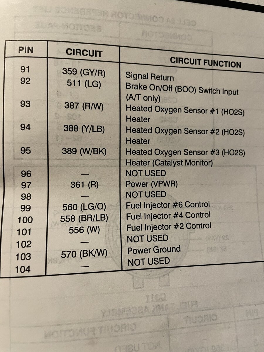

1998 Explorer PCM pinout

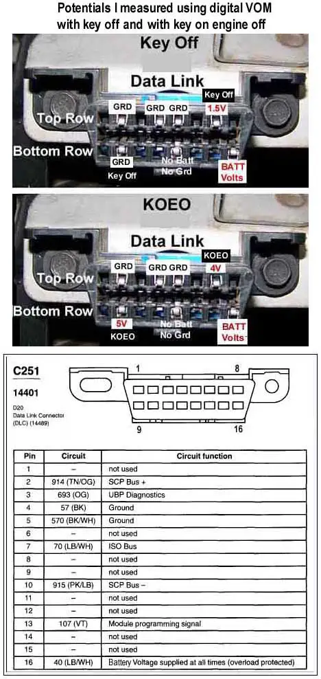

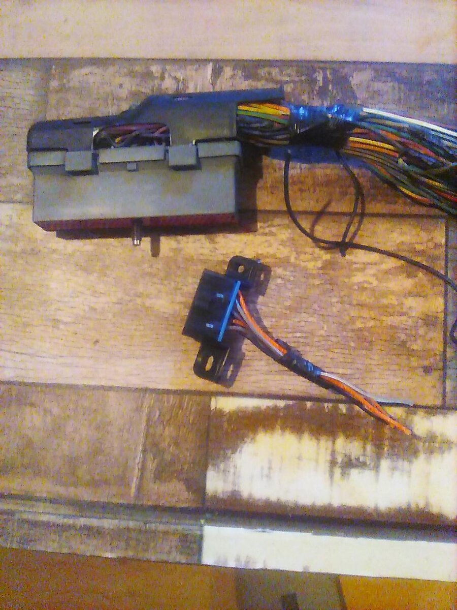

DATA link connector picture out of a 1999 F150. I assume this is the same model to model.

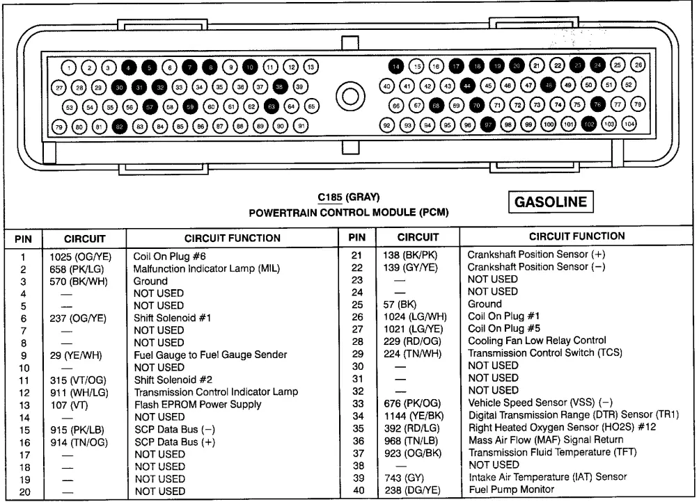

1999 Crown Victoria PCM pinout

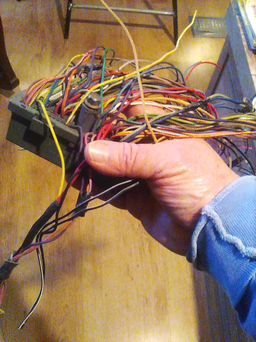

Label wires on 1999 Crown Vic PCM harness before removal. Keep PCM/harness wired stock. Address very few plug end differences.
