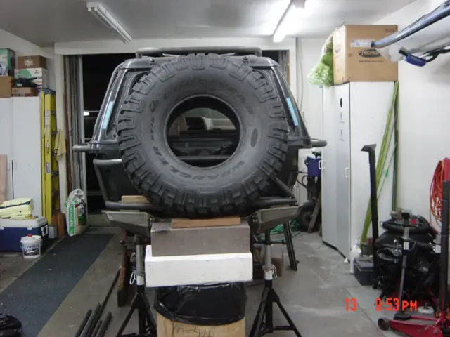

I'm puting my spare back on the back someday. and I think with a 37" tire on the rear visibility is kind of a side thought:rolleyes:
Here's what our 40" tire were working on. But for rear visibility, no problem that's what a rear camera is for.:p:

Gigantamous spare tire = need rack on roof to accomodate it...

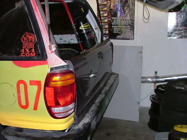

Cut the gate
So here is what I got....

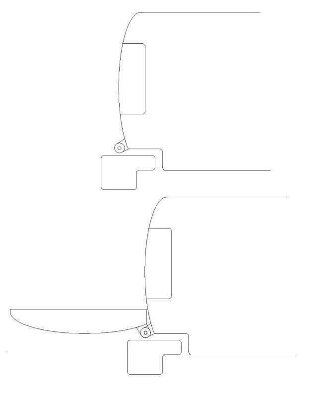

This is the best thing I can think of. I didn't want the hinges outside the body but I think it is inevitable.
Vs Ranger hinge:
Havn't played with Ranger hinge to match yet. Been working on another hinge, and I'm close, but the 2nd gen gate is making it really hard. The curve in it hits the bumper:( I do know that the lower lip of the gate needs to be hammered flat or cut off. It gets in the way to much. Just need som more time, I play with it then think for awhile and come back. I am close though.;)
Well before you cut it off take a look at my hinge placement. Today I came up with a prototype that works great so far. It's just weak and non-removable, so I need to make a new set of hinges now that are beefier and incorporate the Ranger hardware.
I posted the pics in my build thread in my sig.
OK, your sort of going the same direction as me. My idea is to use a standard 4" door hinge and space the hinge out 1 1/2" from under the weather striping. The other side just bolts to the bottom of the door. I think it will work, just not sure if the gate will go through the swing ok.
