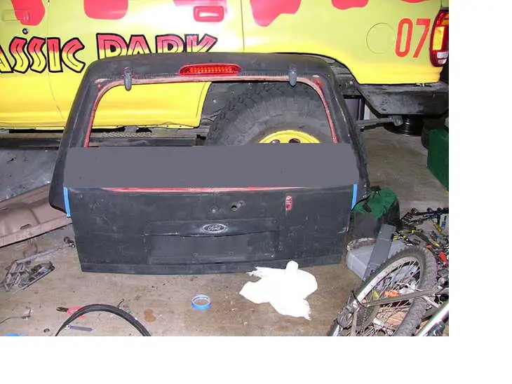

So I have a little project I'm working on which turns a factory Explorer lift gate into a tailgte/liftgate combo. another words I'm cutting the gate in half:eek:

So here is the plan..
I will use the mounting hardware only( hinge) from the Ranger gate. I will also most likly use the limit cables. I plan to still use the factory Explorer latch. this will allow me to use it just like a tailgate with the handle.
Where to cut...ahhh this is the question. I'm still looking into this as the top will still work as a lift gate like on a camper shell. The trick is getting it to seal and lock with out adding to whats there. I'm looking at tring to still use the latch for the glass, and pop the top that way...but not sure if I can make it work.:(
Using tbars truck as a Exsample (Thanks Ted:thumbsup:) I would probally cut on the red line. Sealing the rear glass some how and using everything as is to speak. A 1st and 2nd gen would work the same. Maybe using a piece of plexyglass instead would work better, but the curve of the glass could be a issue.:(
Have you thought about taking the outer skin of the hatch and applying it to the Ranger tailgate? Might make for a bit of a heavy tailgate though.
none of the latchs match up, and the ranger gate is no lockable. it's really just easier to slap a hinge on the bottom of the Ex gate:confused: If I we're cutting the top off, then I would do the Ranger gate maybe.

idk if youve already thought about this or not, but ive been reading though and got a thought.
do you think the latch for the glass would be strong enough to hold down the glass plus the entire upper portion (from the glass up) of the lift gate? i ask bc you could tie in the glass and and upper portion of the liftgate to open together without modification of the latches. for the tailgate you could hinge the bottom section of the liftgate and maybe try to maintain the the factory latches.. if the top section of the liftgate is seperated from the bottom section and you open the latches that hold the liftgate to the body it should be able to be lowered like a trucks tailgate since you now have that part on hinges.
does any of this make sense? it did in my head, but im having trouble putting it into words

My consern of making the upper part of the gate and glass one pieces, is not the latch being strong enough...it's the glass:( I don't have the glass for the spare, and I've thought about plexy, but there is a pretty goo curve on the 2 gen's glass. Also strength again. I'll cross that bridge when I get to it.

noved had a good idea though.. you would sacrifice a little room but it would be a clean fab. weld the side posts of the hatch to the truck.. cut the bottom section flush below the posts and hinge it. you would be able to pop the window still to access the cargo area and have the bottom half as a tailgate.
Hey Steve, you can get them to put the right curve in the plexy glass by taking the stock glass to them when they make it. That's what we did.
Well I was thinking if I can get the curve in there, then I can have two extra holes drilled tord the bottom where there are two rubber gromets for the glass. I can use those holes as for ataching the glass at the bottom for strength.;)
Above your blue horizontal tape lines, could you fab up and weld in sheetmetal, all the way across in the glass indentation? That way, you'll have structural strength in the top piece. Then all you would need is to modify the rear window gasket to fit the new opening, cut the height of the rear glass, remount glass bottom catch, remount glass latch, etc...
Something along those lines...
