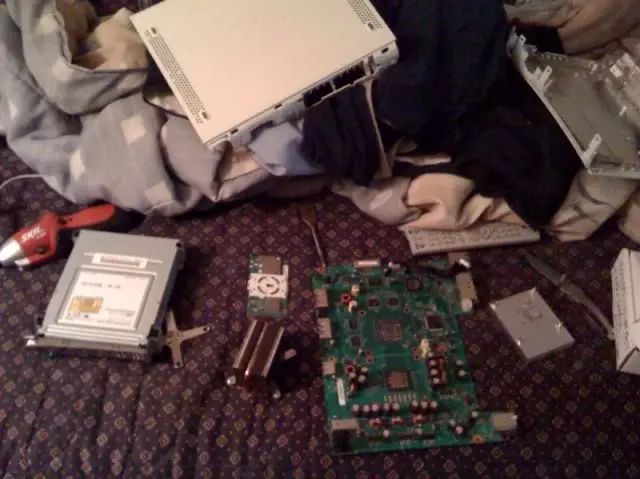

Damn You Microsoft!!1!
Dare I ask what happened here? Specifically to the hard drive my room mate needs to play Fable 2? lol
on the xbox, it had the red ring of death I took apart and attempted to fix managed to get it working twice. But when I'd pic it up or move it it the ring was back so I gave up.
I bought a halo 3 edition xbox off of craigslist. I'm goin to attempt a friends xbox with the red ring.

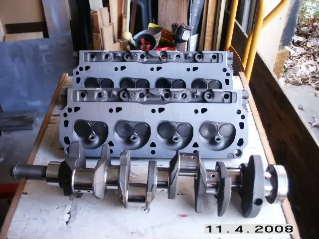

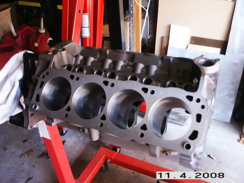

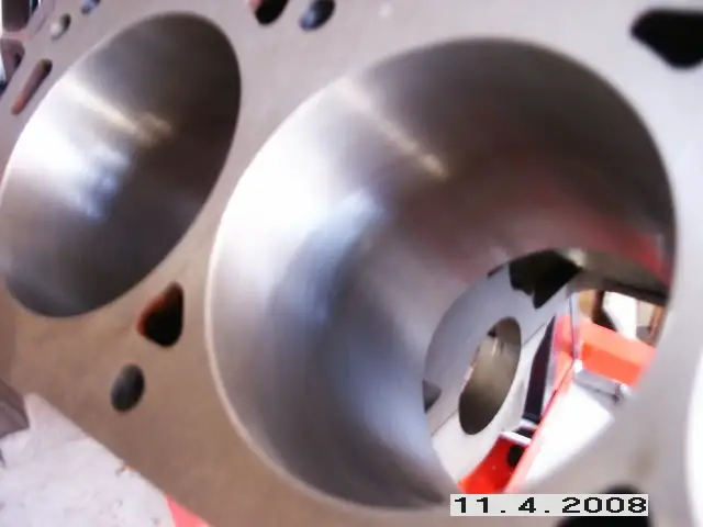

Ok finally some info for you guys.
Block and heads are done. He had the crank on the turner when I was there. Ready to polish the journals.
I can pick it all up tomorrow after I vote.
Thing looks bran spankin new and ready for some enamle.
AAAAAAND, 700$ LATER:
What do you guys think, standard or high volume oil pump?
He polished thcrank journals, so I imagine there is some extra play in them from STD.
