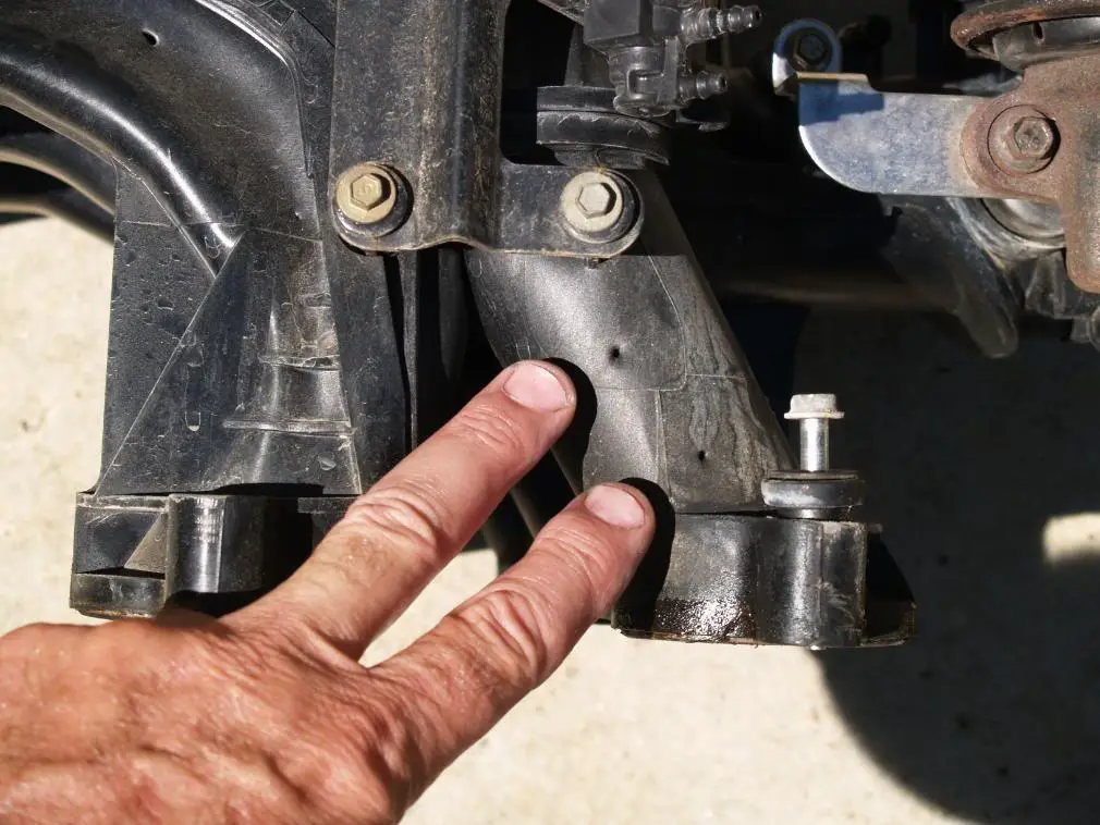

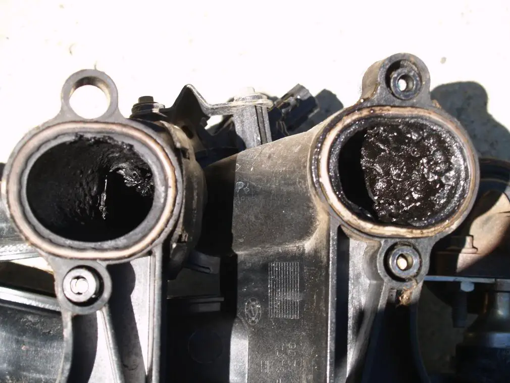

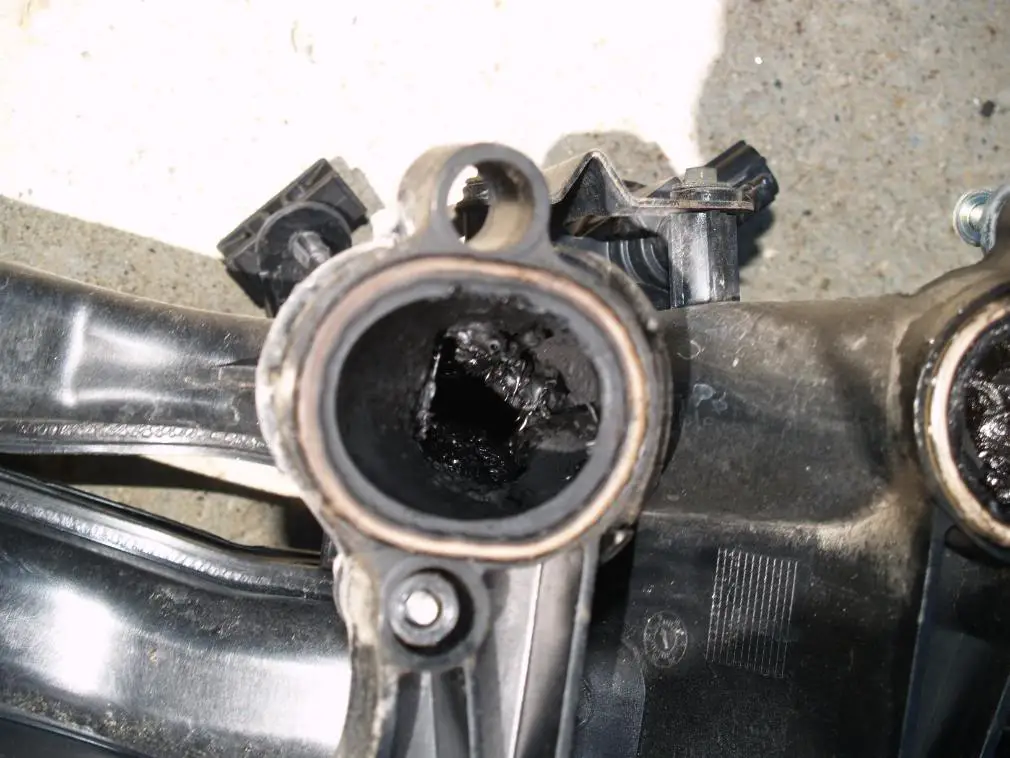

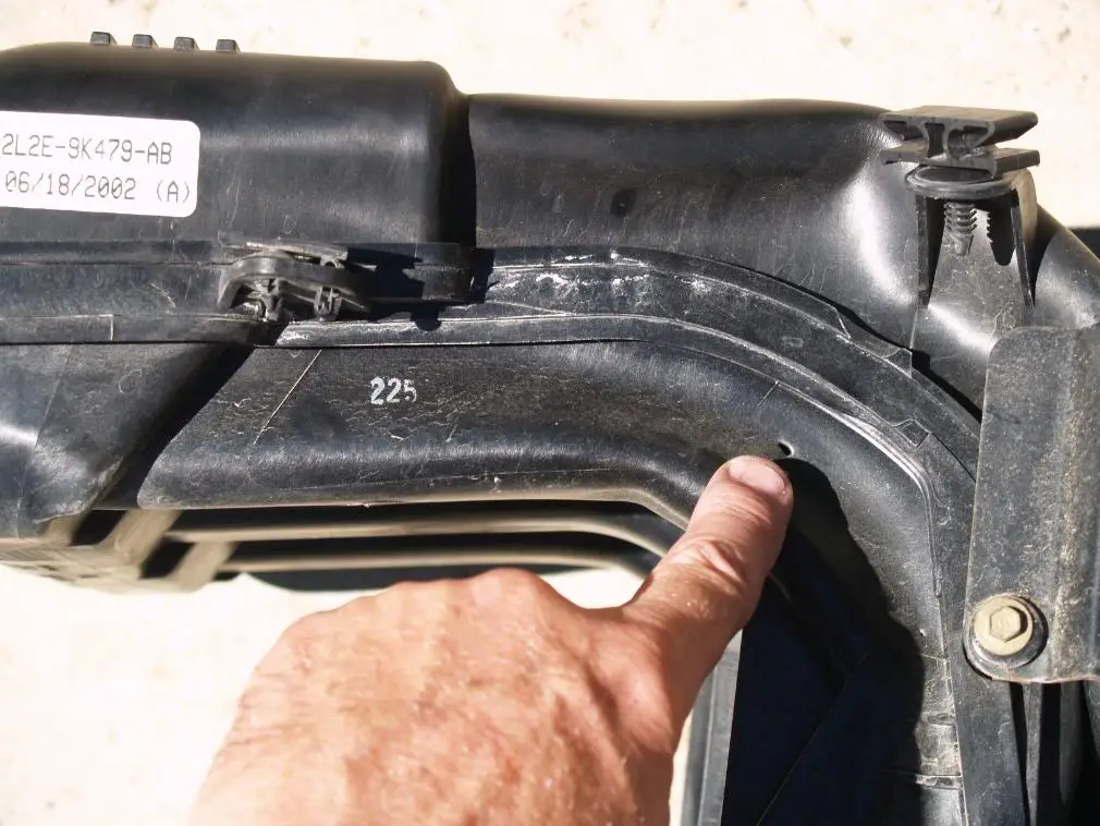

I pulled the intake manifold and there's a normal amount of goo and black crud here and there and then I look into #6 and #5 runners in the manifold and notice what looks to be great gobs of black greasy spooge deposits... I stick my finger in to give it a wipe and it's as hard as..... PLASTIC! Then I see it... the runners are melted inside, some of the plastic has been sucked down past the o-rings, there are giant long vacuum extruded plastic sprues taking up a good deal of the inside, the base near the 0-rings is distorted and when I looked at the outside.... THREE HOLES ABOUT 1/16" DIAMETER! I had a stethescope with the open ended hose on it yesterday because I could have sworn I heard a vacuum leak.... I checked the manifold bolts for torque and they were okay so figured since I'm not familiar with this engine, it must be normal noise that sounds like a vacuum leak... WRONG!
