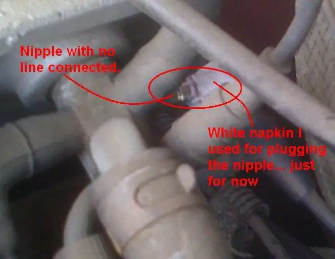

So my truck started idling weird last night. While stopped and gear on P the tach will oscillate a bit, but as soon as put into gear D it would go crazy.... the engine will rev up and down 400-800 RPM, almost killing the engine sometimes....
At first I thought that it had to do with something electrical (coil), since I recently installed a remote start system on it (see my DIY link at the end)... but it was nothing of that sort....
Today with sunlight I took a look,and found out the cause.... I noticed a loud hissing that was coming from the open nipple in the pic (I have mi finger blocking it)... As soon as I blocked the vacuum leak the car started to idle normally... I have temporally "fixed it" with a plug (made out of a napkin )
There was obviously a vacuum line there before, but I cannot seem to find it (I looked)... can somebody help me out (look at your car) and tell me where/what the line should be... what does it connect to? where is the other end? (Pics will be great too)
Thanks!
Tona
