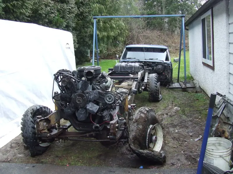

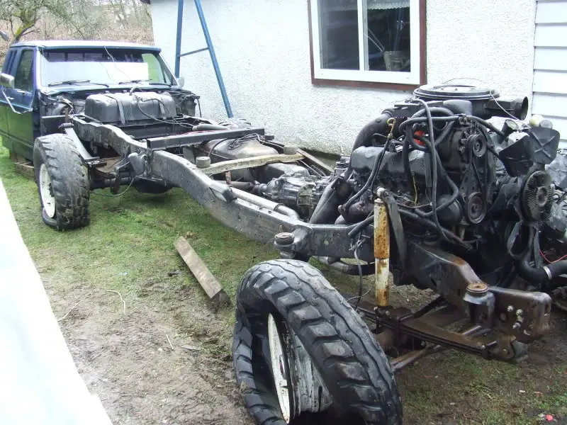

Looks like that F250 has some lean to it, weak springs maybe? Other than that, looking good![]()
the yard slopes on the driverside
truck sits level on flat ground

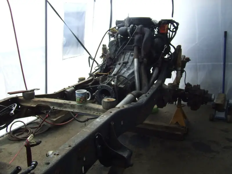

are you going to part out the remaining rolling chassis from the explorer? i might be interested in the wheels and perhaps the ZF5 from the F250.
i have a low mileage '76 460 sitting waiting for my crewcab but i don't wanna us the c6 that is in it now. i prefer manual but don't want to use an NP435 or T18. does the 6.9 have the same bellhousing pattern as the big blocks? the e40od you show a picture of looks like the same pattern as my 400 & 460.
the diesel has its own bolt pattern and I am pretty sure I have the zf5 already sold
and yes I am parting out the rest of the explorer drive train when I am done

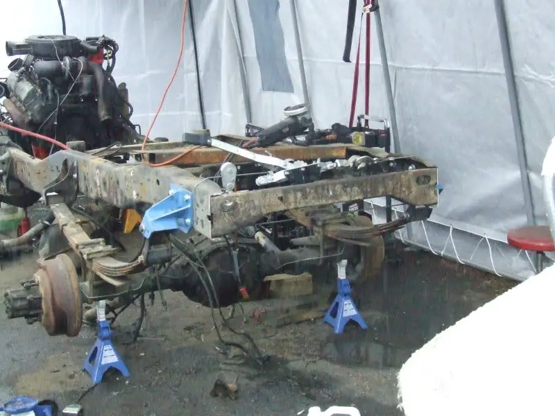

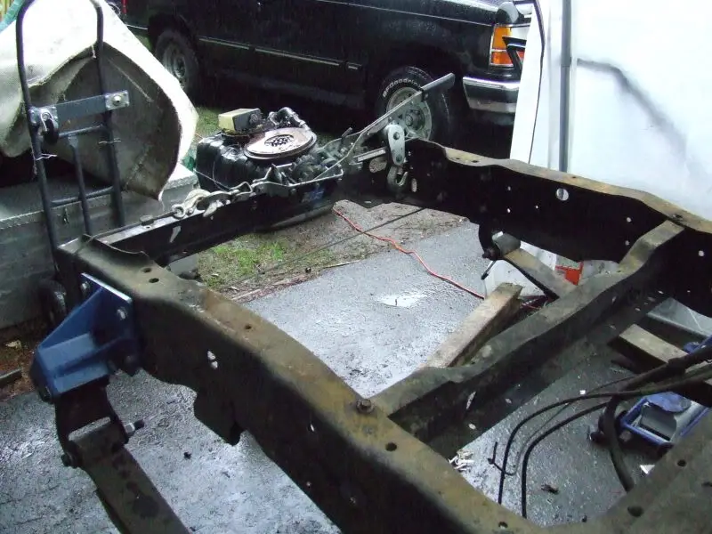

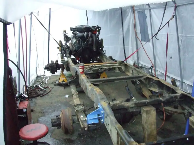

after three days of fighting with rivets and drilling holes for brackets
killing 2 grinders and one drill and one chuck the frame is now shortend by 21"
giving me a wheelbase of 112"
now I can start putting things back together

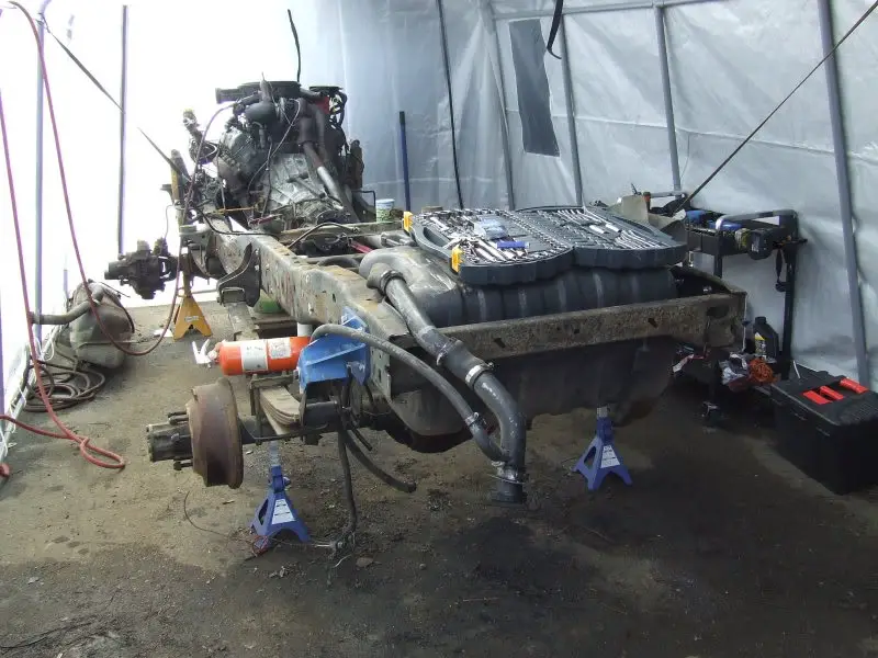

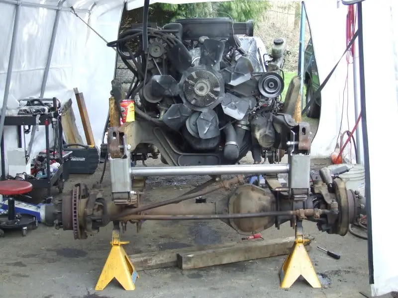

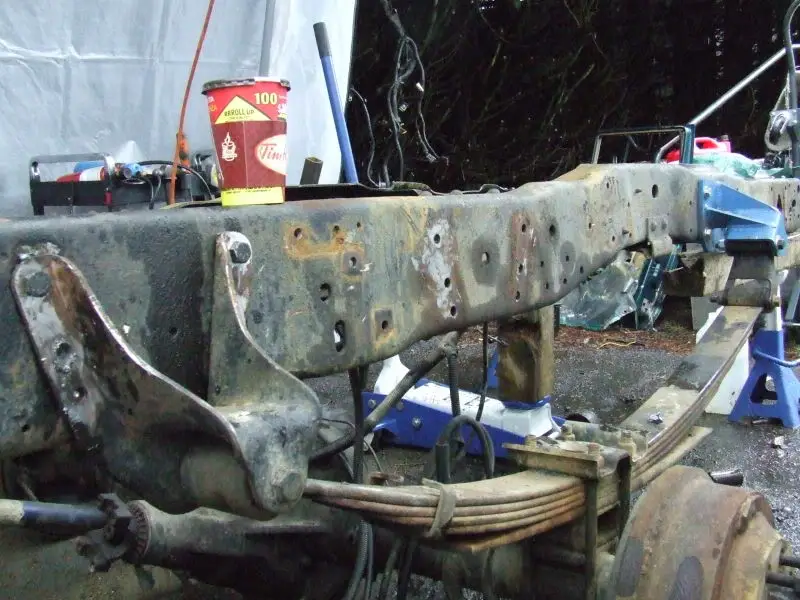

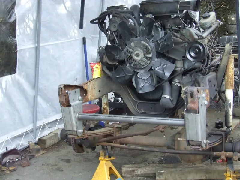

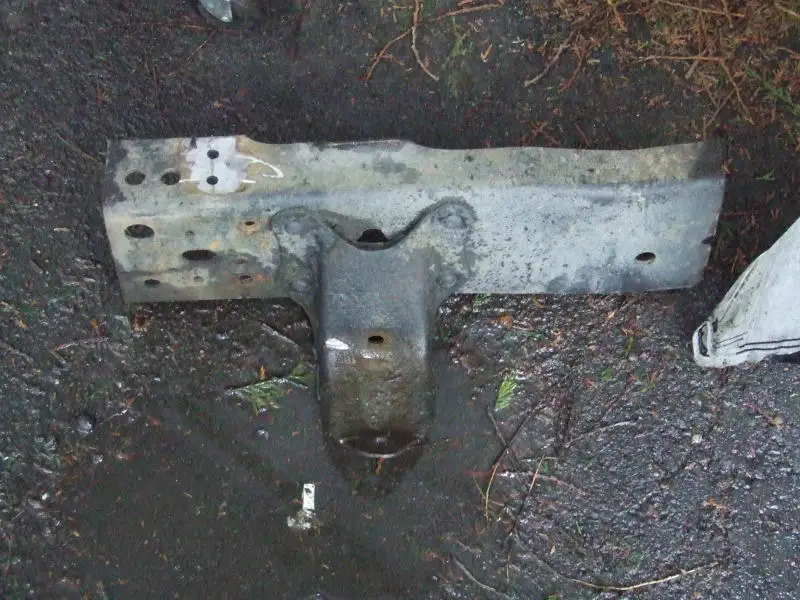

ok lift is mostly in frame is done cept body mounts but I need the explorer body off the frame before I can work those out
and the tranny is in and tcase is coming tommorow as well as a bronco gas tank skid plate so i can lower the tank to fit the body
still need to fab up something to fill the gap in the front frame around the spring mount
thats the sky manufacturing 5" shackle reversal kit

I see a trip to Timmys was in order during the day! did you win on the rrrroll up?
Si
i am lucky my wife keeps bringing the timmies home everytime she goes out
bad part is I never win the roll up but she always does lol

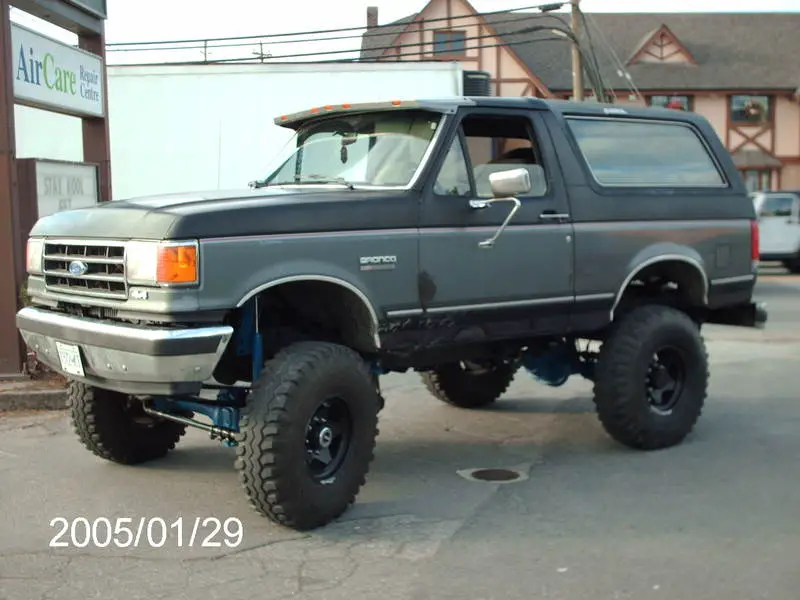

i saw something like this in off-roading magazine...a guy took two diesels out of f-250's and put them into two different bronco's...it was badass
been there done that 89 bronco with a 90 7.3L diesel zf5 and super duty axles and 36" tires
this was my diesel beast
all the build pics here for it
http://s75.photobucket.com/albums/i313/malaktrizan/Diesel Beast/?start=0
