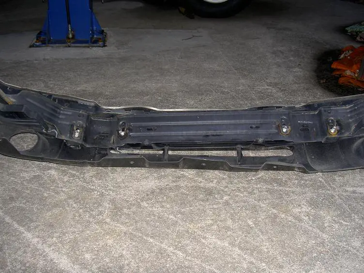

The bumpers in 95-01 will all swap. The inner bumper has to go with the outer skin. Meaning that all of the plastic covered versions must have the inner structure. The frame mounting is the same, the same four bolts and nuts. The fog light connectors will be different.
Many have swapped the various Mounty parts onto Explorers, check out E.......X.com, and search for 99SportX, he was about the first. He, Eric, is also here, hunt his gallery for his Sport with the Mounty front grille and bumper. Below is a 99 Limited back section. Regards,
