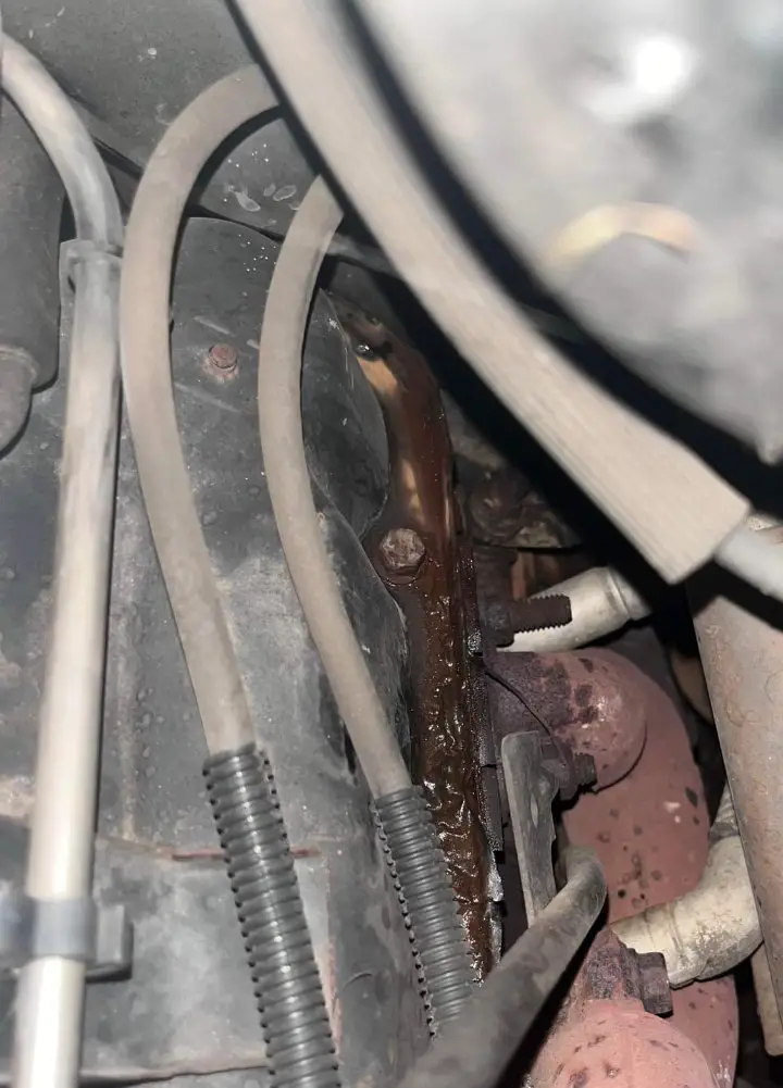

My 99 explorer has been leaking around the back side of the valve cover on driver side could it be the lower intake gasket on that side leaking
Is it leaking coolant?
Yes it could be the lim gasket
It was leaking till I put a stop leak it's been good since but I know it will need to be fixed correctly.
