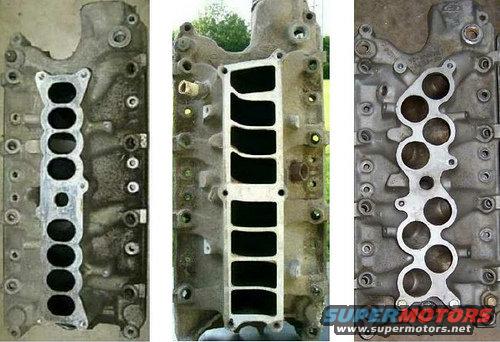

Here's your 302 EFI lower manifolds, who know's them left to right?:
Mustang, f150, explorer......... The F150 lower is a decent option. The upper sucks but obviously you won't need it.
I'm guessing for your application you will only need the lower intake.
You would be fine with the F-150 intake...I didn't know that;s what it looked like. Nice factory piece.
