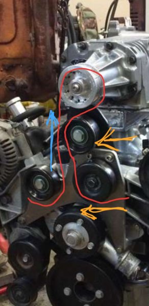

The snout support should really just be to oppose the force of the belt pulling down, in the type which is mounted to the lower intake. Most of the weight is supported by the plenum bolted to the blower body.

Red squiggly line is belt.
Blue line is the force that the bracket has to oppose vertically.
Orange line is the forces that need to be opposed horizontally.
However hard it pulls "down" it then also pulls with the same force to the "side".
I guess none of this applies to you though as you are doing a secondary belt feed to the blower. As long as you put the idler and tensioner vertically you should have zero side load.
