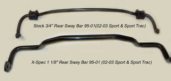

I think tires would be the first place to start for improved wet weather traction. The original tires are only adequate for your vehicle. There are a lot better choices available. For improved cornering definitely goe with our X-Spec rear sway bar upgrade. The front is ok as is. But our rear sway bar will improve handling and decrease body roll. There is currently a group buy going on for the ZD5622 Sway Bar for $159.95. See the group buy section for details. Your handling will only improve when you lower it and replace the shocks. Your Sport has a lot of potential.
