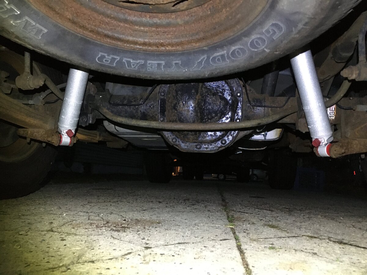

Today 12/23/2021 I changed the rear shocks. I mentioned in post#3 in this thread that there were shocks with helper springs on them, on the truck.
I bought some Rancho RS90000's, part number RS999185 for the back. These shocks are adjustable and I have had good luck with them.
When I removed the helper spring shocks the back dropped down about 1.5 inches. I decided to drop the front down as well so I went 6 turns looser on the torsion adjustment bolts. My driveway is far from straight so I will have to find a parking lot that looks straight and do some measuring, the passenger side looks like it sits higher than the D/S like many explorers do.
The truck rides way better now, the suspension absorbs bumps instead of bouncing off them.

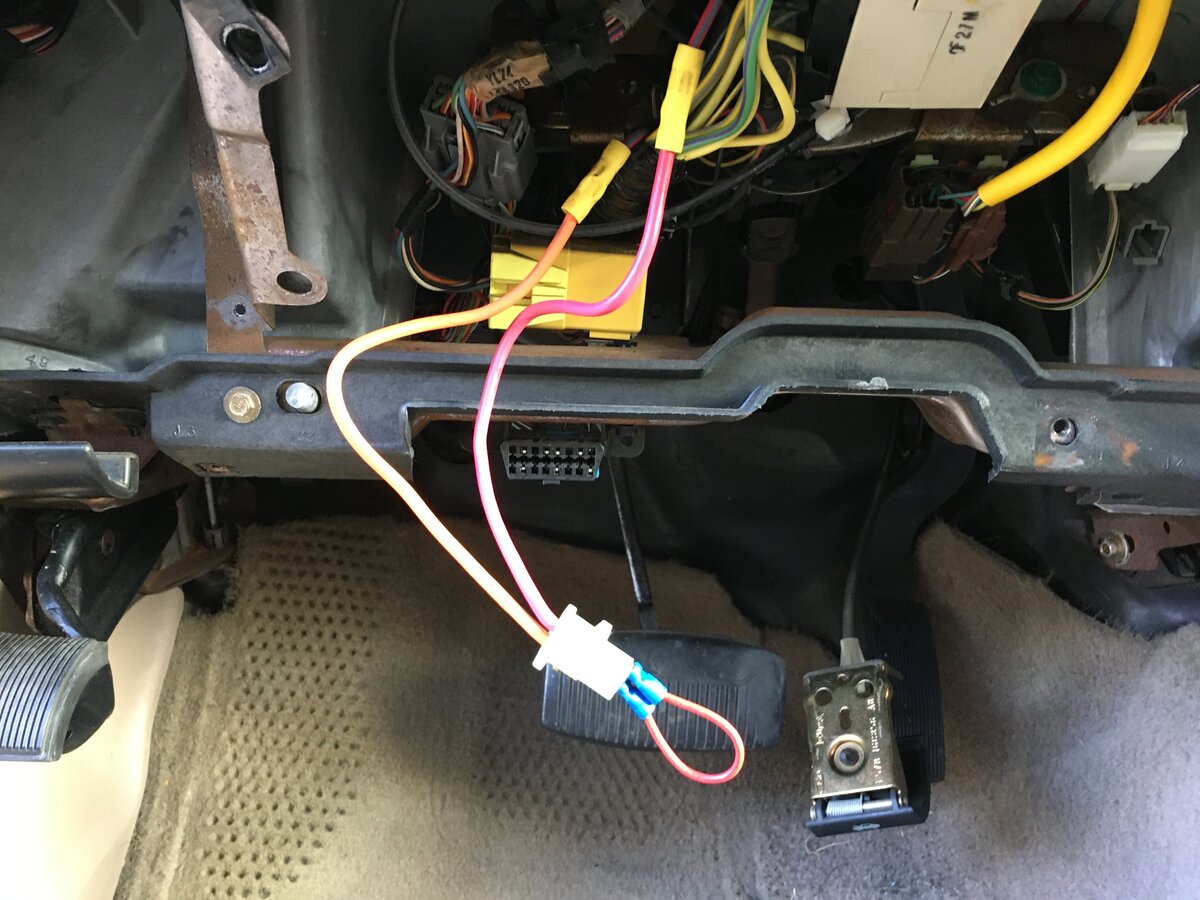

I had to do a few things first, one was removing this dealer installed aftermarket security device.
This thing is a type of key that has to be plugged into its receptacle like shown, for the vehicle to start.
Here is a picture of the security module with the model number 6900A on it.
The key has Silencer on it so that must be the name. Imagine losing that key, it would make your vehicle real silent because it wouldn't start.
This device is installed by cutting the starter signal wire coming off the ignition switch and adding this module in between the two halves of the wire. The module will open or close the circuit depending on whether or not the silencer key is inserted into the receptacle.
There is not too much to this thing, just the six-wire connector that goes to the receptacle, the two larger size wires that interrupt the starter signal circuit, and the smaller two wire attachment which is the ground and a horn wire. The horn wire was not even attached to anything on this vehicle.
The easiest way to remove this device and still be able to start your vehicle is to simply unplug the two larger wires and put a jumper across the connector. I tried this skinny wire just to have proof of concept and my vehicle started without the silencer key.
I would recommend using a much larger wire for a permanent solution, using a skinny wire like I did could result in a fire.
I removed the jumper and installed a remote start system attaching it to these wires and soldered it.

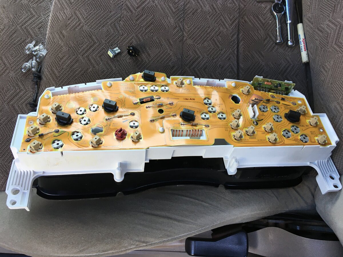

The other thing I wanted to do was install LED bulbs in my instrument cluster. One bulb was bad, and I like the brighter look of the LED's when installed. I tested them to make sure they lit up before putting it all back together. I use these square little 9 bulb LED's, they work well, and I have not had any flicker or burn out in any of my Explorers.

I put just one LED bulb in center of my cluster when I had it out for odometer gear replacement and sure enough it's now flickering like many other ones I got off Ebay / have installed in my Jeep.... if you want to list link of your ones there (since you've had good luck with them) that would be cool.

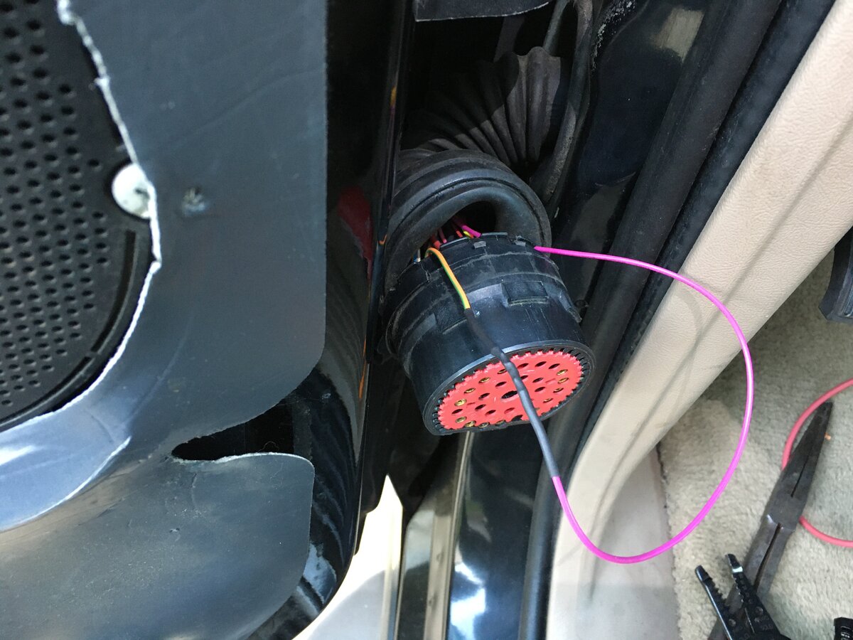

I did a continuity test on both circuits from the radio to the speaker connection, and one was open (orange with green stripe).
Next I separated the door to vehicle connector and checked the wires in the door and they were both good with about .3 ohms.
The two speaker wires go from the back of the radio to a connector under the dash by the parking brake, I found the orange with green stripe and it was good from the radio to the connector under the dash. This left only one part of the circuit that goes from under the dash to the door jam.
Inside the rubber piece that all the wires go through, in the door jam, I found the broken wire.
This can be a tricky place to fix a wire but there is a method that has worked for me a few times.
You pull the rubber piece off the body of the vehicle and pull the wire out of the back of that piece and add a length of wire to it, then feed it back in there and solder it to what's left of the wire at the connector.
I used an old transmission dipstick for a wire "fish" tool. It worked better than the metal coat hangers I have cut up and used in the past.
I shoved it through the rubber piece, slid the wire through the rounded end and pulled it back out the side closest to the connector.
A little solder and heat shrink to keep it sealed and it is good to go.
I shoved the excess wire back into the rubber piece, pulled the rubber piece back onto the connector, and installed a new zip tie on it.
