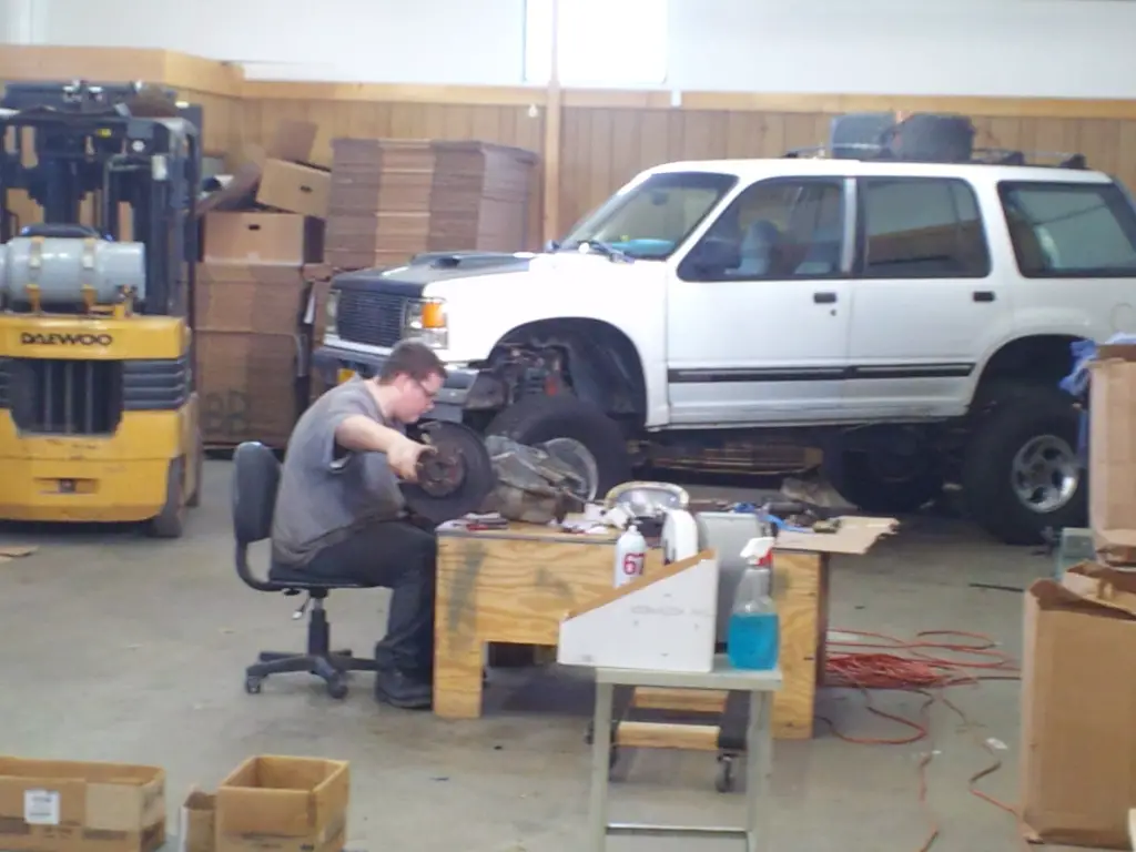

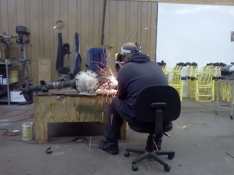

cut the old sway bar mounts off. changed both wheel seals. my locker is missing the shims creating way to much slop. but it made getting the c-clip out so much easier. lol :/
jd doin work! but he just had to find a way to sit down while doing it! haha
hahaha should have got one when they was flying 20ft in the air!!:sawzall::sawzall:and dear god im sore,truck kicked my ass!!
O and what you talking about?????who was sitting down in the chair first??:nono::nono:
