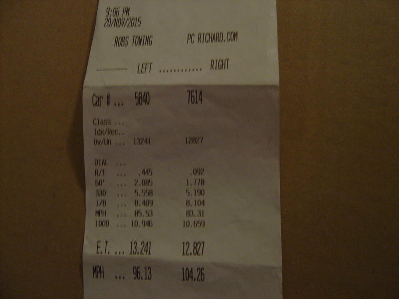

Finally beat my previous best time of 12.93
New best time - 12.83

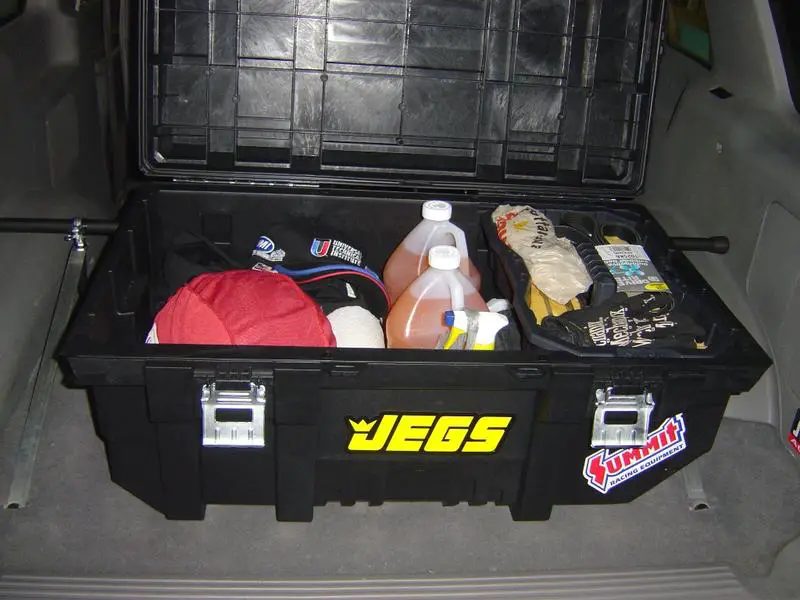

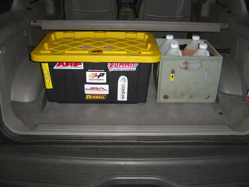

I was using a plastic container and a milk crate(see first picture) to carry my racing gear/few tools and Rainx to the track. You can not have anything loose inside the vehicle when racing for obvious reasons, so I would remove them and leave them in a parking spot while I made my runs.
Sometimes when the tracks were really crowded, people would park in font of my things when left in a parking spot.

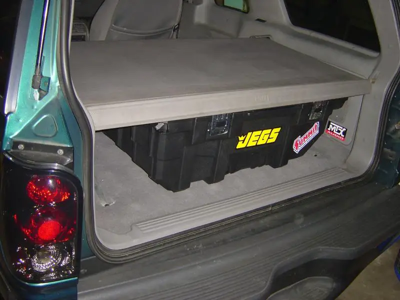

With that in mind and sometimes traveling to different tracks, I wanted to find a way that I could leave all my stuff inside the truck. I needed a container with a securable top that was tall enough for the Rainx bottles and other stuff I bring along. I needed a trunk for my Explorer.
So I found this plastic container that is just the right size, and it has latches and even a hole for a lock (if needed) to keep things closed in. It had wheels and a handle that I removed since I would not be needing them. I bolted it down with 3/8's bolts and aluminum straps that I made. Weighs in at 16 lbs empty. I didn't weigh the whole thing when full but it probably is about the same as the rear seats I removed(around50lbs). The good thing is I wont have to worry about leaving my stuff in a parking space anymore.

I'm always amazed how fast you can do things.
I feel like I'm always waiting for something.
