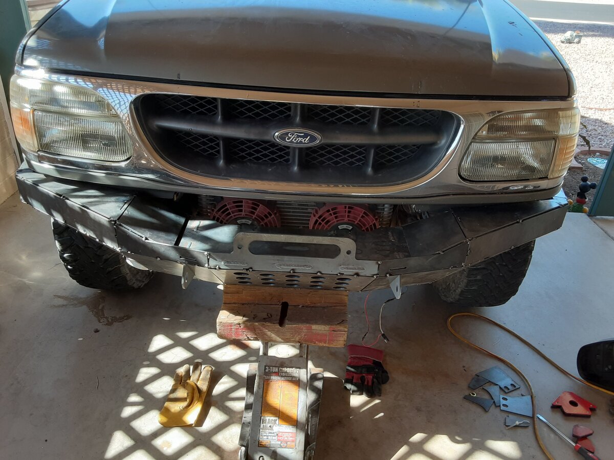

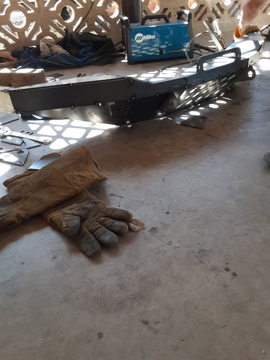

Got some progress done on the bumper.
Does it use the stock frame horns?
I see they are still there. If so, ask him to weld them solid. Factory only spot welds them, for crash crumple reasons.
Hope you have time to paint it before your trip!
It does use the stock frame horns, however there are gussets included to weld on behind the horns. They are welded behind the horns and to the frame. As you can see, I had to cut the inner portion of the horns off to make room for the grill guard after the body lift. I found the cut off portion for the right side, however can not find the left side. We plan to weld the removed portion back on the right side and use the gussets for added strength. Then somehow fabricate a replacement horn for the left side and of course make sure it is up to the task it has. Also, my external trans filter was sitting right behind the mount on the right side outboard of the frame. We're going to make our own gusset for that area that is bigger so it can serve the purpose of reinforcement and a place to mount the filter.
I had to tap my 99's left frame horn back into shape when I put it back together. I had checked on those to see how much they'd be, and how easy to get. They were reasonable in 2006, even Ford had them. gman's right, they could use some added welding, they can easily be removed if needed.
I loved that spot for an external filter also.

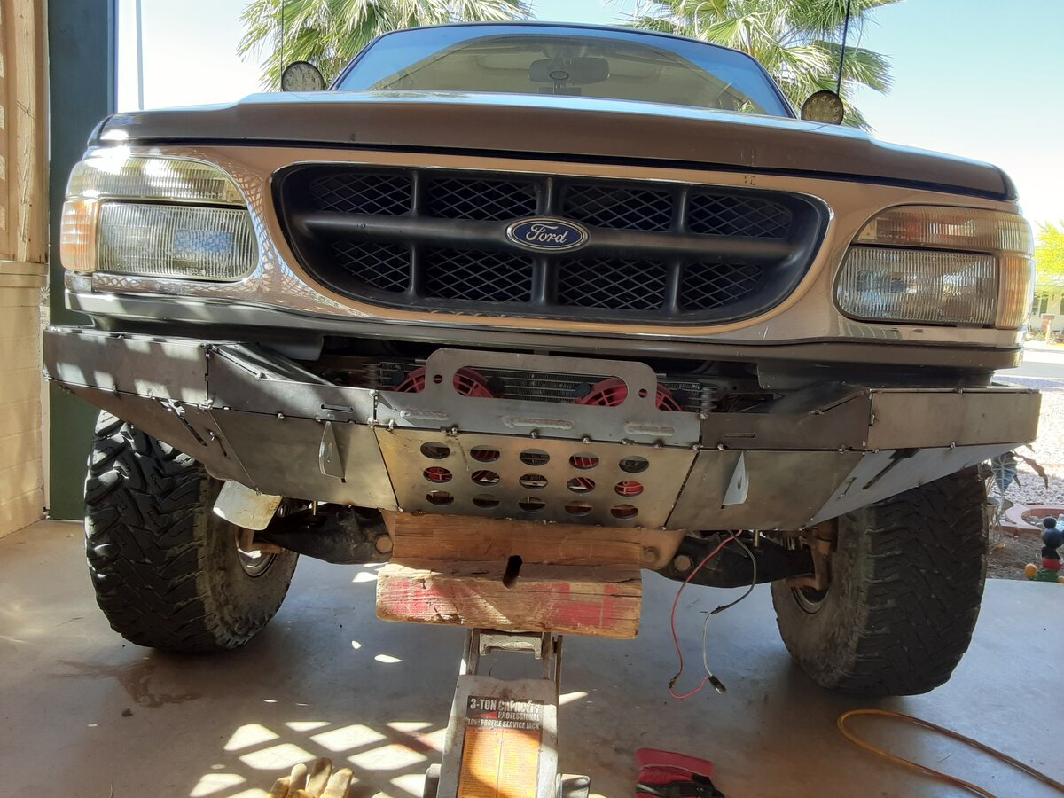

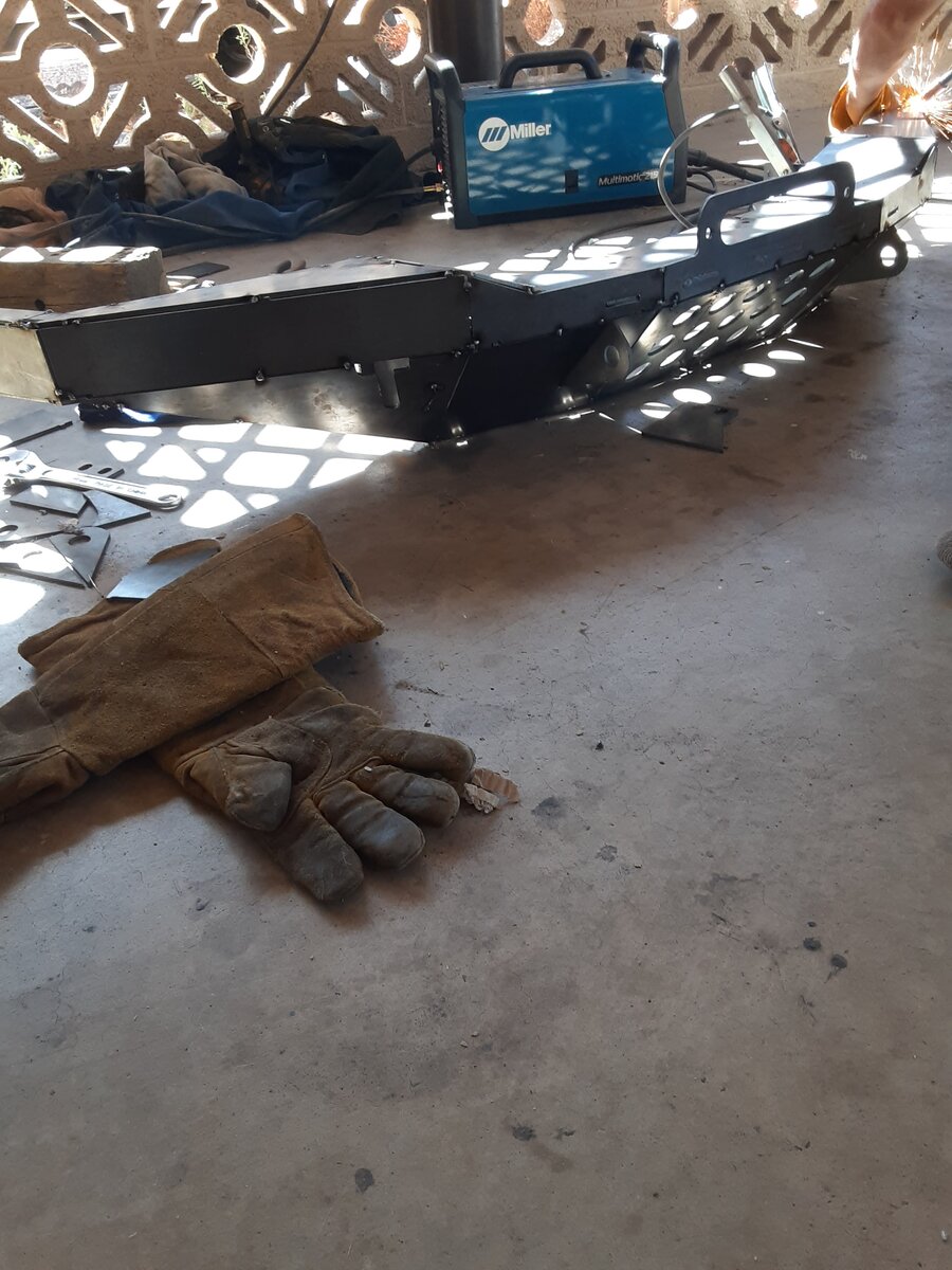

More progress....
Finishing welds tonight. Tomorrow the brackets and gussets are being done. I'm doing the finish grinding while that is being completed. Hope to get it painted sometime this week.
Just remember, can always do it at the campground. . . .
Good work.
LoL true, I could. But I've decided to try my hand at real painting with a compressor, paint gun, etc. If I can't get that done in time, then I guess I'll just pack a bunch of rattle cans. :)

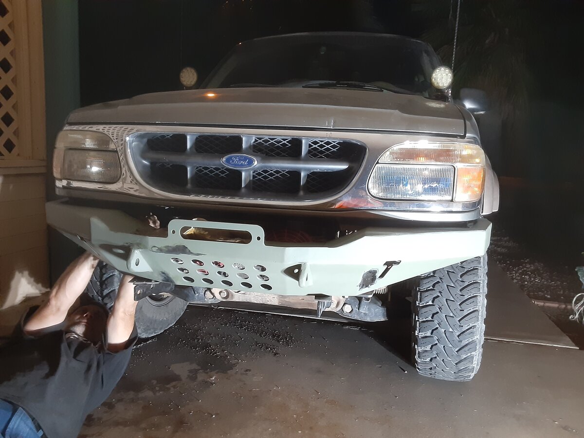

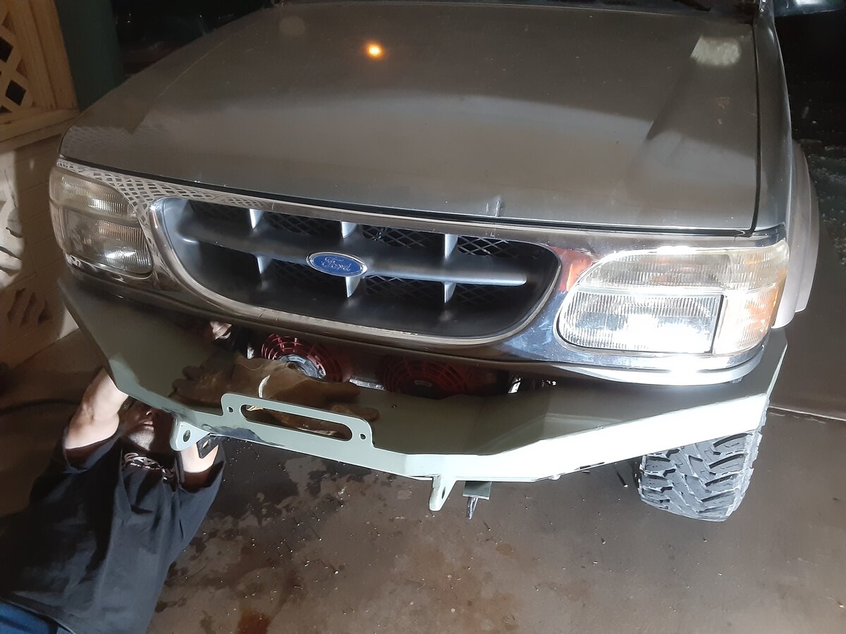

Well the welding is all done, brackets strong, grinding on the visible welds is complete. I'm gonna shoot a final coat of primer tonight and then paint is tomorrow. 😁
Pics then

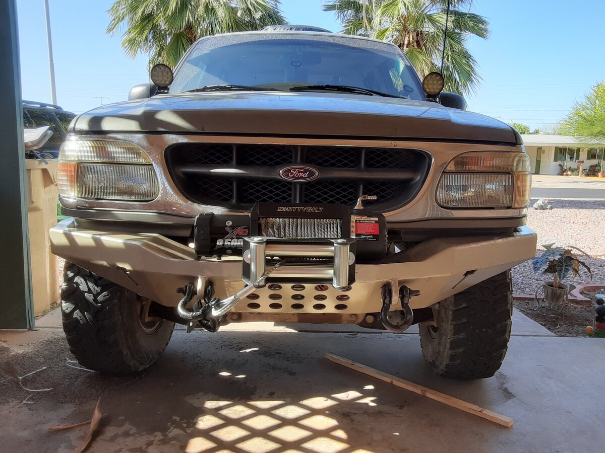

Progress....

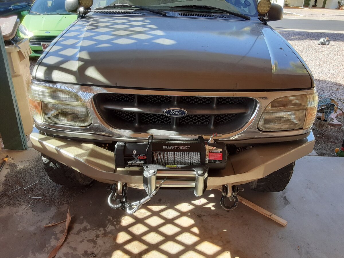

Paint and winch. So hope I didnt screw up by mounting the winch before attaching the control box...
Give it a good test when you get it wired up, like this if you ever saw the movie;
It may be my imagination. But I think the extra weight lowered it just enough to improve the camber. LoL
Quick question, theres the pre first use procedure of the winch. I dont have access to a gentle grade. So I was thinking of the gravel alley, and airing down the Explorer tires to 18psi. Then hooking it to a solid object (I.E the Expedition) and using the winch to pull the Explorer and spool the wire. Think that'll provide enough tension?

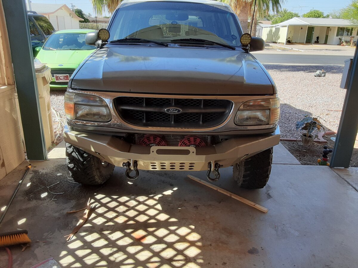

Got Lil Eddie back a couple days ago. Finally got the rear axle repaired and the locker installed. WoooHooo! I've joined the ranks of locked rear diffs! Now its my daily driver for a couple weeks at least while I go through the break in period. I'm sure that time will let me know what else needs to be repaired, updated, or just plain worked on. Already thinking front shocks, I know it needs new boots on the steering rack, and maybe new tie rod ends....
Also gotta figure out how to mount my lights with the new bumper.
