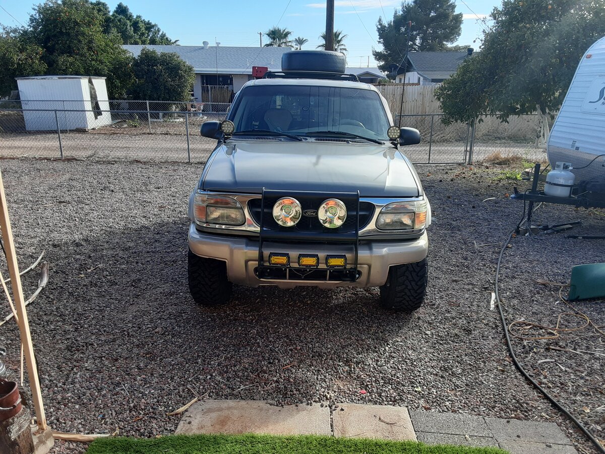

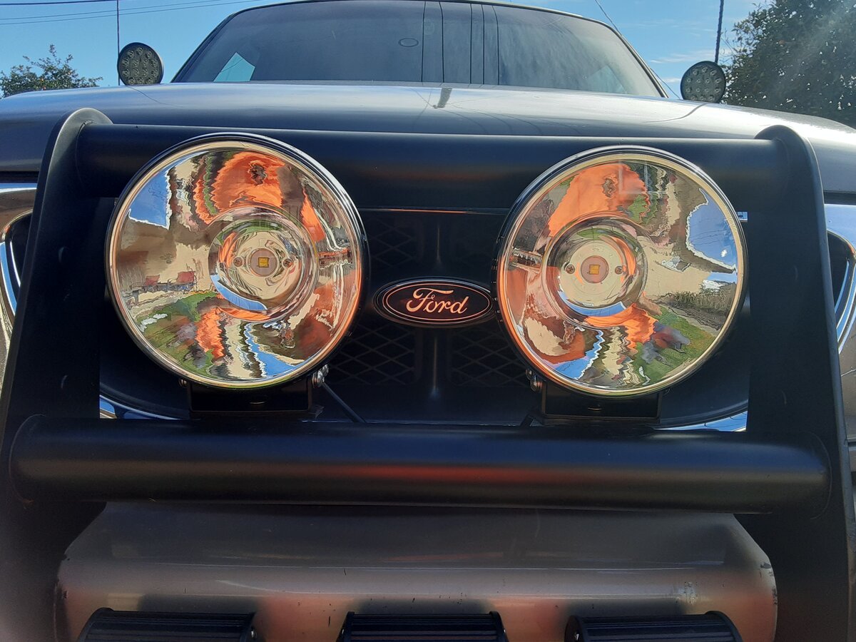

I tried out the previously posted lights and though they are bright, they have no focus, they appear to be even more spread than flood lights. Sooo moving on I got these monster 7" LED spot/driving lights. I think i finally found my sweet spot of retro KC highlights looks with modern LED tech.
Hmmmm I suppose I could use the previous set of lights on roof rack facing to the side for camping.... well until I decide they are up for sale.
