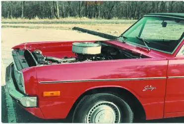

What a kick! An old friend of mine just sent me this photo of my first Dodge Dart from 1983!

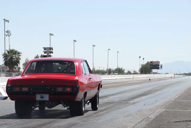

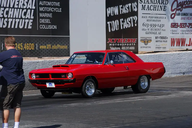

Made three shake down passes. The first was 18.55 @ 68mph, then 11.66 @ 101, then 11.58 @ 109.
First off, that's quicker than my first Dart ever ran. My all time quickest prior to today, was 11.86. Not bad for the first time out and a driver who was afraid to give it all she's got... Not that I was actually "afraid". I was just being cautious not wanting anything to go wrong on the first outing. I never made a full pass under power today. I was backing off the throttle before it picked up too much speed. The idea for today was just to feel it out and see how she handles. It went so straight on the first run I felt comfortable enough to give it a bit of gas off the line on the second and third. I actually thought I might not run faster than a 12 or 13 today. Just had no idea how it handle.
Now that it's home I'm going to go through the valve lash again and make sure everything in the valvetrain looks good, no burned pushrods, etc. I was also running it a bit lean. The carb needs more jet, and less fuel pump squirt. Time for a bit of tuning... I didn't have my O2 sensor on today. I felt that would just add a bit more complexity to the process, so I left it off, and just read the spark plugs, old school...
Anyway, enough blabbing... Time to upload pics and then get the video edited and uploaded.
Thanks to my friend and neighbor Fred, for taking the still shots, to Brandon for coming out and offering your expertise, and to Char for putting up with all this, and shooting todays video:chug
BTW, today was 10/10/10 and the car number was 01. Binary day!!
Best slip of the day...
To give you an idea how early I got out of it, I was doing 96MPH by the 1/8th mile mark, and only 101 in the quarter. So, I basically just drove it at that speed from the 1/8 mile on... For it to only take 11.58 seconds to complete the quarter at that speed, shows what kind of potential is left in the car.

SIMPLY AWESOME!!!!!!!!!!!!!! Seems I can hear a little bit of a throttle tap at the very end there.
Thanks!!! I'm still pumped!!
I never put the thing all the way to the wood yet, not even off the line:eek:
Didn't try the line lock either. I just wanted to keep it all as simple as possible today.
I think that means you got scared at the 1/8th mile and let off of the throttle :p:
From the sound of that run, you've got quite a bit left to play with!! High 10's??????
Great job Rick!!!
