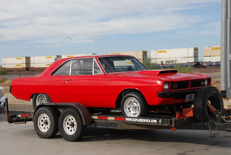

A couple weeks ago I bought a 1970 Dodge Dart off of E-bay. The car was located in New Jersey, a mere 2500 miles from home:eek: I decided this was the right car for me mainly because I really needed to get out of the house on my own for a couple weeks and this was just the excuse I needed;)
The car is going to be stripped and repainted. It will get new quarter panels, at least one rocker, one floorpan, new door hinges, fiberglass hood, bumpers, and most likely trunk lid as well.
The new color will most likely be orange, but it just may end up being red, like my old one. Plans for it include a 650HP, 512 CI, big block Mopar and an automatic transmission. I'm just not sure if it will be from BB or SB or whether or not it will even be a Mopar:eek: I plan on ditching the torsion bar front suspension for an aftermarket K member which gives you rack and pinion steering, upgraded brakes, and the choice of coilover shocks or airbag suspension.
The rear end in the car right now is a trussed Mopar 8 3/4", with a three link suspension and coilovers.

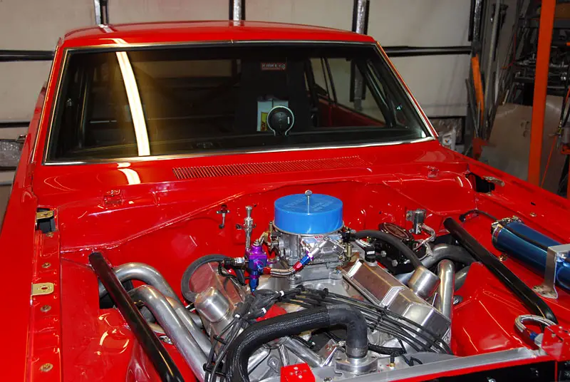

Glass installer showed up today without a windshield gasket. I specifically asked if they were bringing one when I made the appointment three weeks ago, and again two days ago when they called to confirm the appointment. I ordered a gasket from Dante's and it will be here on Wednesday. I have another appointment to install the windshield a week from today.
I know what's another week after three years.... Thing is I was sooo looking forward to having it behind me with just a front end alignment between me and the first time at the track:burnout:
At least the rear window was installed and is looking fine!
Why do you need a windshield for a front end alignment? Throw it on the trailer and take it down there.
We need to adjust the weight balance with everything in place before the alignment.

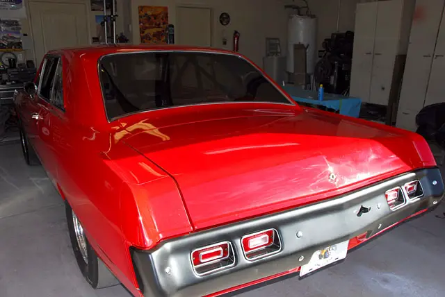

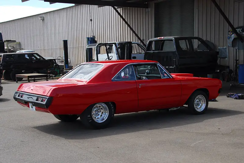

It's a car!!!
Wow. Just..wow! Great job rick. Looks like all that effort payed off. :thumbsup:

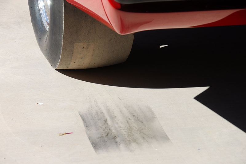

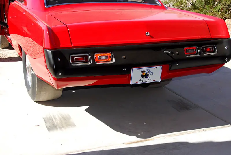

First burnout!!!:burnout:
Like a kid at Christmas, I couldn't help myself...
Man, it didn't take much at all to turn the tires over:eek:
One more burnout and that sticker patch on the left tire will be gone.
A little CSI tells me that you hit a high RPM due to the track width at start, which is full width and as the RPMs went up the tire increased in diameter and starting to run more on the center, which is normal.
Then it went a little to the right just where the sticker came off judged by part of it to the left of the burnout.
I think you're reading too much into that patch;) I doubt it got to more than 3000-3500 rpm. I stabbed the throttle just a bit and let off just as quick as I could. Maybe 1/10 of a second:dunno: I was actually quite surprised it turned the tires over at all.
