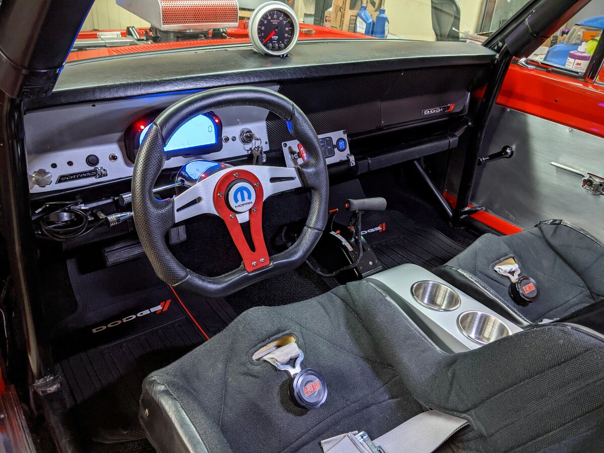

Finished the leather covered arm rest for the console today. It's also the lift for the cover. There is a magnetic latch that keeps it shut tight.
This pic reminded me that I need to come up with covers for the door handles.

In other news, I finished the floor with carpet and floor mats.
