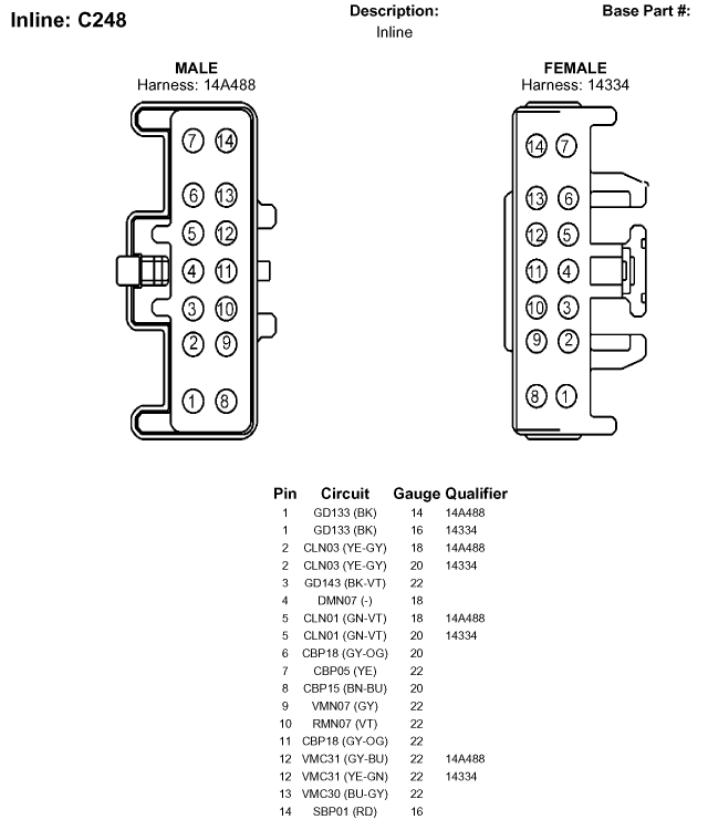

If anyone can help me and take a picture of their 2008 explorer wiring connector at the bottom of the drive side a-pillar. The reason i need to find out then i can replace this harness with a 10-pin connection and install a mirror with microphone, this help will be appreciated very much and I will include a picture of the wiring circle in red so you know which one i am talking about. My sync project is almost completed : )
