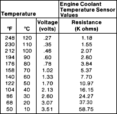

A leaking fuel injector can cause a rich condition but is probably unlikely your source of problem since both banks are running rich. The PCM adjusts the injector pulse width according to engine temperature and air temperature. I would think that a dirty MAF sensor element would result in a lean condition since it detects less than the actual air mass flow and you have replaced the MAF sensor. My guess is that you have a defective engine coolant temperature sensor or a poor electrical connection between the ECT sensor and the PCM. If the PCM erroneously detects the engine as colder than it actually is then injector pulse width will be excessive and the O2 sensors will detect a rich condition. Below is a ECT sensor chart of temperature vs resistance.
As you can see from the chart, as the temperature decreases the resistance increases. If there is an open circuit due to a broken wire or loose connector the resistance will be infinity and the PCM will think the ECT is extremely cold. Don't mistake the engine temperature sending unit for the dash indicator as the ECT sensor. The easiest way to check the sensor is to plug a PID reader into the OBD-II port to determine the PCM read value.
