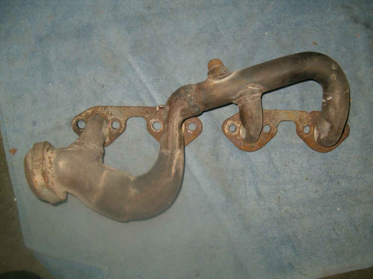

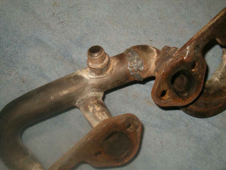

I wanted to show this
Passenger side header from my 98
See how the tube is cracked and re welded. The top tube is stainless, which is welded to cast material for the "belly" tube
An exhaust leak on passenger side, will cause low egr flow--that is the EGR bung sticking off the top tube.
This is shown with the metal heat shield removed
