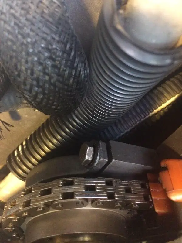

Working on a reinstall and here is where I am. I have the new left camshaft timing chain, sprockets, and guides in (the left cam sprocket loosely installed). The new main chain, sprockets, and guide only installed (the new jackshaft bolt is only snugged in right now) and the crank sprocket is in correctly with the recessed portion facing the radiator for the balancer.
My problem right now is the right hand camshaft. In the picture below, you can see due to the A/C lines there is absolutely no room to put a socket or even the socket and extension from the timing kit on the bolt for the right cam, should I need to loosen it. It was a battle just to get the holding tool and I had to loosen the main wiring harness on the back of the block to get that on.
Everything is very close to being in time right now, crankshaft and the right and left camshafts. My question is, can I use the tools to lock down the position of the right camshaft in time now, hoping that I don't have to loosen and adjust that cam during the timing process? I understand once everything is tightened up underneath the timing cover, the only adjustments are the positions of the cams, and even if the right cam is in the correct position, if I have to move the crankshaft, that won't matter anymore because it too will move.
I really don't see a way to have access to the right hand camshaft bolt without disturbing or removing at least one of the A/C condenser lines.
Any ideas or input?
Thanks,
Chris

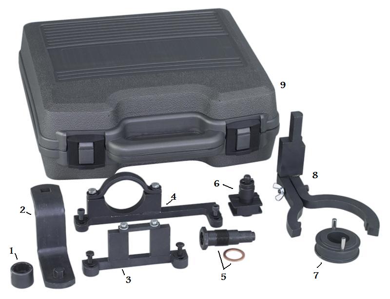

shop manual procedure
My 2002 Explorer shop manual procedure for loosening the right camshaft sprocket retaining bolt only requires removal of: valve covers; fuel supply manifold; serpentine belt; thermostat housing; and camshaft roller followers. There is no mention of A/C lines. Are you trying to use the special tools for the right camshaft in the timing tool kit that fits between the bolt head and the firewall?
Use items 1 and 2 in the above photo.
Yup, those are the tools.
Ok, so I just tried it again. I had to put item 1, inside the camshaft holding tool and adapter (items 4 and 7), and then put it on as one assembly. I have it on now, along with item 2, so it is possible. I ended up removing some of the wire loom material around the A/C line to give me a little more room, but it's still very tight in there.
