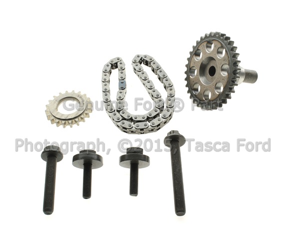

If you purchase the primary chain timing kit make sure you get the one for 4WD instead of RWD. The crankshaft sprocket is different because of the balance shaft.
I ended up ordering the 2U3Z6D256CA Kit that you have listed in your parts thread. According to the fordparts.com website it is compatible with the 4WD version of the engine.
Thanks!
Chris
2WD vs 4WD
The current outer crankshaft gear P/N for the 4WD is 2L2Z-6306-AA. The current outer crankshaft gear P/N for the 2WD is 2L2Z-6306-BA. The jackshaft/primary timing chain kit P/N 2U3Z-6D256-CA I purchased was for 2WD and included 2L2Z-6306-BA. I don't see how it could also be suitable for the 4WD. Also, the kit contained the primary chain tensioner and guide. The photo Tasca lists for the kit no longer includes the tensioner and guide.
I urge you to contact fordparts and confirm what you're getting is correct and what you want. Also, Tasca has the kit listed on ebay for $185 + $15 shipping. However, I don't think the kit fits 4WD. I've used Tasca for years. If you give them your VIN they'll confirm you're ordering the correct parts.
Edit: Frankly, I think you could get by with just purchasing the tensioner P/N YL2Z-6L266-AA for $36 + shipping. That way you wouldn't have to loosen the front jackshaft sprocket and retime the camshafts.
Ok. I ordered from tousleyfordparts.com which forwards you to AutoNation Ford, White Bear Lake, MN. The kit was roughly $170 plus shipping. I just used the fordparts.com website as reference when you brought up the discrepancy.
But I see what you're saying regarding the crankshaft gear and the different part numbers.
I would like to just replace the tensioner and guide, but my brother (previously a mechanic) insists that the chain is now stretched and should be replaced since I already have it apart. Furthermore, if I'm going to do that, I may as well do the left cam cassette to.
I'll verify the information tomorrow and report back.
Chris
similar components
Your components look very similar to the ones I purchased from Ford and installed several years ago.
Don't forget to position the outer crankshaft sprocket so the recess is near the radiator instead of the block. In your photo it is in the wrong position on the chain relative to the jackshaft sprocket. If it's installed backward the harmonic balancer will not seat correctly and the serpentine belt will keep jumping off the balancer.
Will do. I remember seeing that pointed out in your assembly write up. I'm sure I'll be asking questions and posting pictures as I reassemble to make sure I'm doing it right. I don't want to screw this up. :eek:
