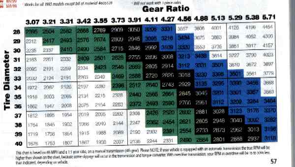

Now, 6.72s with a 33 tire -- that's over-geared! (the ratio in rockwells)
Here is a quick chart that I often use to figure out gear ratios with tire sizes. The chart is setup to indicate RPM @ 65 mph with NO overdrive, so factor in your overdrive (typically .25, so multiply the RPM number by .25) for final RPM.
Color code:
White -- out of possible RPM range
Green -- lower than stock RPM - economy gear - not for off-road or tow
Black -- stock RPM range - daily driver - all purpose, factory gear
Blue -- Higher than stock RPM - performance and power - off-road and tow

FYI, we drove my kiddo's truck from Louisville to Moab, Utah and back with the 4.56 and 33s. We probably averaged 85 on the freeway. No big deal. They are NOT overgeared!
You have to remember that as the tires get larger, they also roll out further. Changing tire size to a tire 5" larger in height gives you about a 16 " longer roll for every rotation (measure circumference, subtract the difference). that 16" roll is close to 18% difference in length from the stock tire. That means that you have to add 18% gear to roll the same way, have an accurate speedometer, and turn the same engine RPM.
The chart just makes it easier to see the difference between tire size and gear ratios easily. Anything in the black range is considered exactly the same as factory stock. 4.56 with 33s is in the black.
