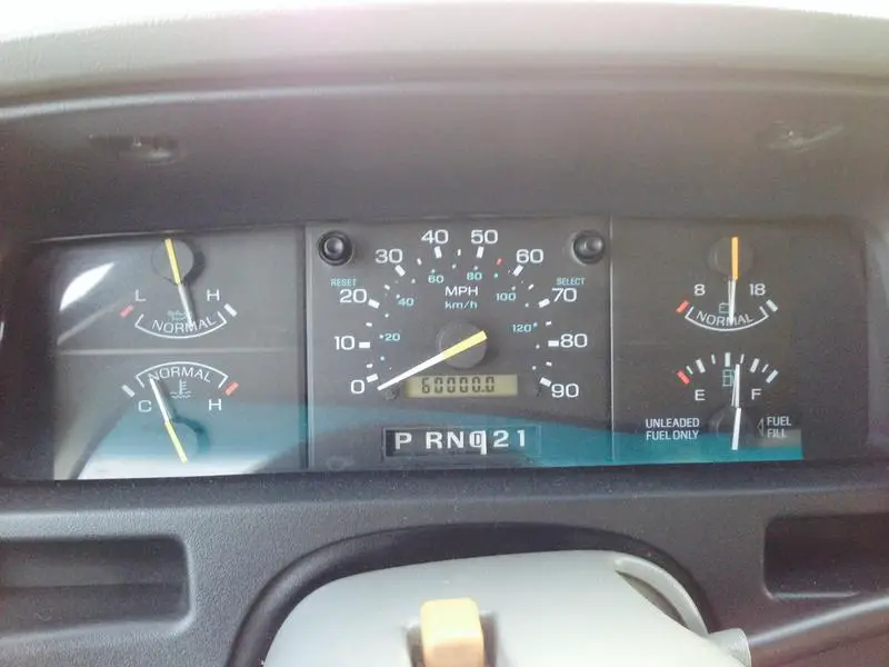

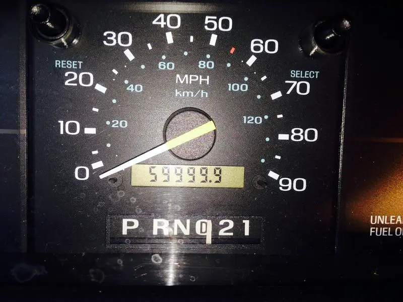

The 1996 Aerostar Made finely made it to 60,000
I've been following along on another post that's saying you should be prepared to see it start over at 300,000 miles after it goes past 399,999. :D
