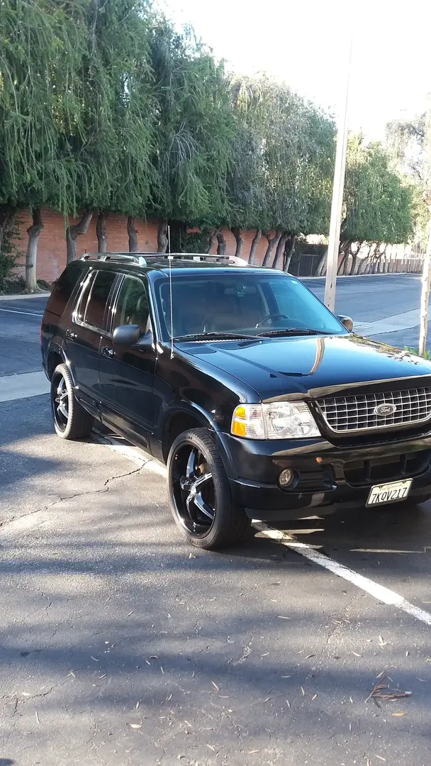

So I purchased this new to me 2004 Explorer Limited 4.6L AWD for relatively cheap with 105xxx miles on it. Seller assured no mechanical issues all matinance up to date etc, etc. Test drove it probably 20 miles with zero issues. A few day after purchase I got the dreaded rear end whine/vibration. Changed the diff fluid added friction modifier and good so far. Ended up replacing fuel filter plugs and oil today. Plugs and fuel filter were original and oil didn't look so hot so obviously the owner didn't do all scheduled matinance. Now here lies the big problem, the transmission. After driving for 15-20 minutes i get a 2-3rd gear flare. It's only happened twice put od light started flashing today and a few weeks ago. When my elm327 scanner worked i pulled the p0745 code. If I reset pcm trans shifts perfect for a few days. Also seem to have some electrical gremlins most likely due to a remote start which I'm not sure even works as I didn't receive fob with purchase. I'm at a crossroad take the chance and replace solenoid block or trade it in. Any advice is welcome. And a few pics
