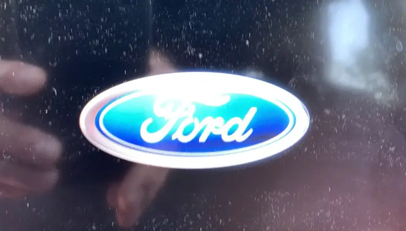

On the APIM, I enabled "Front Camera" and "Visual Design to MY20" and "Type of Volume Knob" to horizontal.
Not sure if I like the horizontal volume. It looks like the Ford logo is different. Sorry not the best pics.

I was wrong with that Ford logo above. It is the same for every setting in the "Visual Design" section. The setting for "Visual Design" doesn't seem to make any changed for me. I set it back to MY20 anyway.

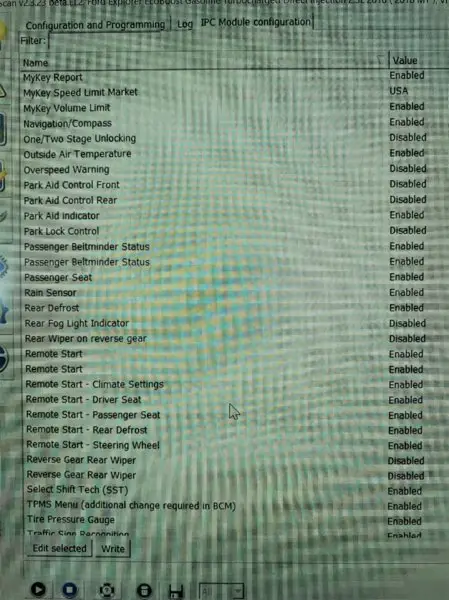

I can't get the outside air temperature on my IPC3. Does it just enable an option to enable/disable? Does anyone have this working?

Also look in the non As Build IPC module. Maybe it is in there.
I added it to my IPC 2.

That's what I'm afraid of. I've seen it on IPC2, but not IPC3.
Here is a pic of the non As Build IPC (had to add a filter because I took a pic of my computer screen):
That's how it looked in FORScan for me, too. It didn't work. I then checked the ASBUILT view and it had the correct address changed. Maybe it just doesn't work for IPC3?
