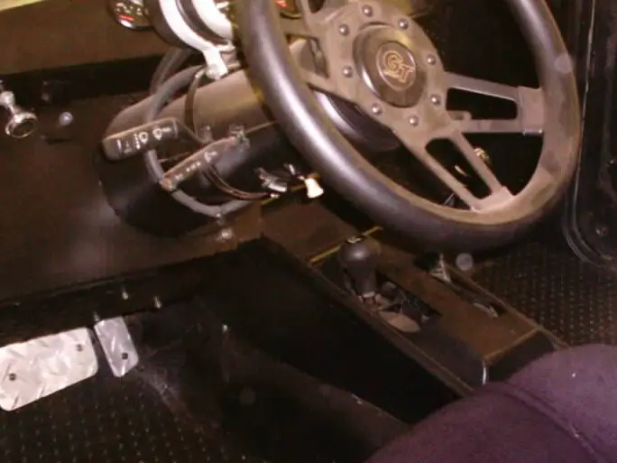

Center console used 14 gauge sheet steel and some scrap 1 inch tubing for the frame which I thought would look good on the outside, with the sheetmetal welded to the inside with several bends and a rolled section at the rear.

Broncobra-console
Had her out today and got a little dusty...there isn't any water or mud to be found, since it's only rained 4 inches here in the last 12 months. All the farm and ranch tanks (ponds) are dry and very little water in the streams. It's dry, but it was fun to cruise a bit...fire hazard in effect so off roading is just about closed to everyone except the property owners. Had about two thousand acre (local) burn two days ago...cause unknown, but took several different fire departments to contain it.
