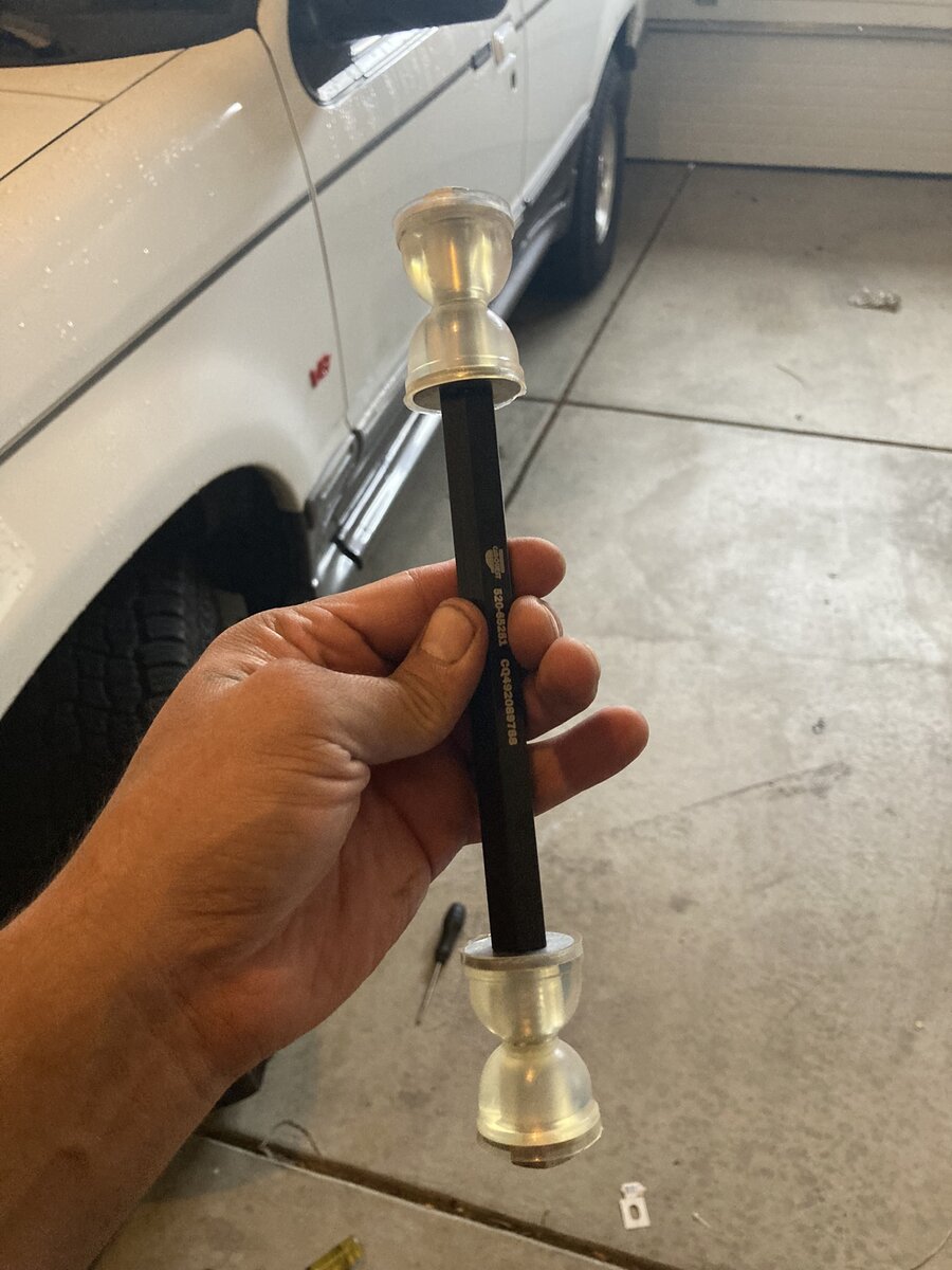

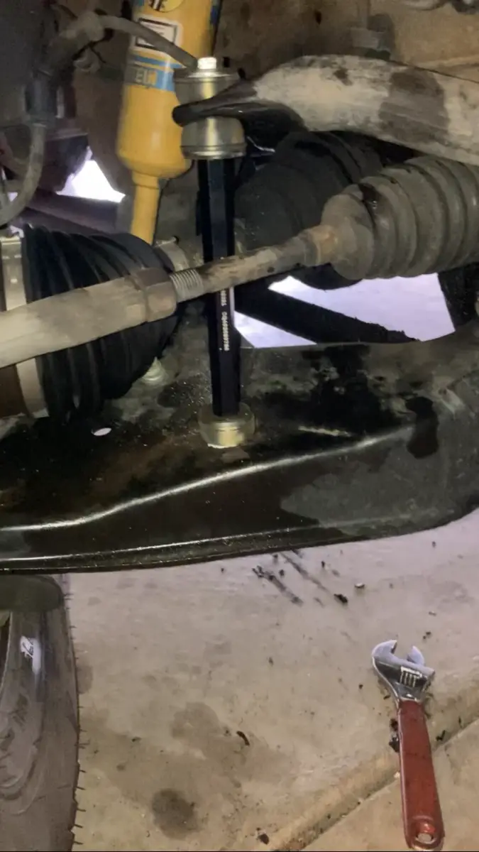

I’m new here! I’ve got a 98 exploder 5.0 awd XLT with 245k..
I just replaced the sway bar end links with polys from car quest. I’m wondering how tight they should be as I have no torque wrench.. Also, I have rubber bushings in the rear sway and front sway bar.. is this I save to have? Any info would help
646C07D1-9B9E-4F77-82F6-478197674B36.png 8CE70676-F836-4B13-A3F1-5AF66805957B.jpeg
you tighten those until the clear plastic little ring at the center of the "hourglass" pushes out to fill the hole in the control arm. From your pic it looks like you have done it correctly.
Yes it is perfectly safe to have rubber in one sway bar and poly in the other
Lets see how long these last! That style usually lasts 3-5 years LOL

im not entirely sure of their spec but i tightened em down pretty good with a 3/8. not overtight but pretty tight. the crush on mine looks very siniliar to yours. are the rubbers OE or new? ive got poly in the end links and all the sway bushings. to confirm youre saying the front end link is poly rest is rubber? i see nothing wrong with that

Yep the end link bushings are poly, and the bolts and sleeve are new. I wanted to get either moogs EE or motorcraft, but I also didn’t want to wait for parts to come in.. what would you fellas suggest for a longer lasting part? This exploder is my girlfriend, and I don’t mind spending a little extra on her for something better!

that setup should last a decent amount of time imo. I have energy suspension ones, very good imo. for the sways i like poly much better than any rubbers. imo if it aint broke right now, dont fix it ;) and lol!!!!

Depends on how the truck is used. On road, they’ll last many years.
I used to chew through the polyurethane ones rapidly. These hard plastic guys seem to outlast them by quite a bit.

Your CarQuest (Raybestos?) end links look good. Are they solid bushings? Unless Moog changed it's probably good you didn't use theirs.

These ones feel really solid so far and no squeaking.. I did hear the moog ones weren’t as good as they used to be so I went with the carquest end links because I was on a budget…I saw in a thread her that someone used the moog Bolts with meatier bushings… that’s a good idea!

Install them unloaded, then drop the vehicle on the ground and see how tight they are. if the bushings don't turn with your hand when the vehicle's weight is on them you are good.
