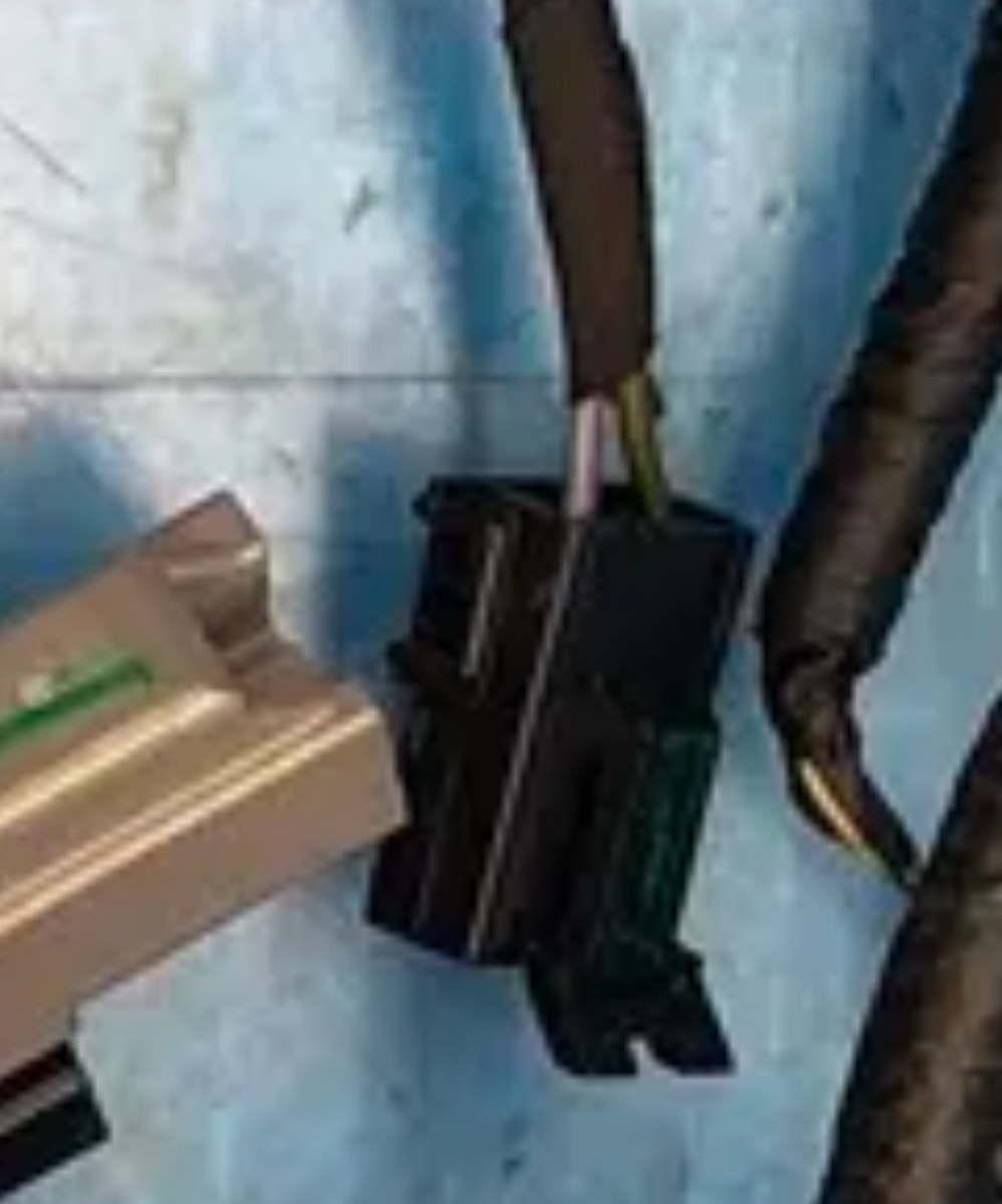

Part
3U2Z*14S411*ZAA
$95 at dealer
I bought the part on parts geek.
https://www.partsgeek.com/catalog/2...y_electrical/seat_lumbar_motor_connector.html

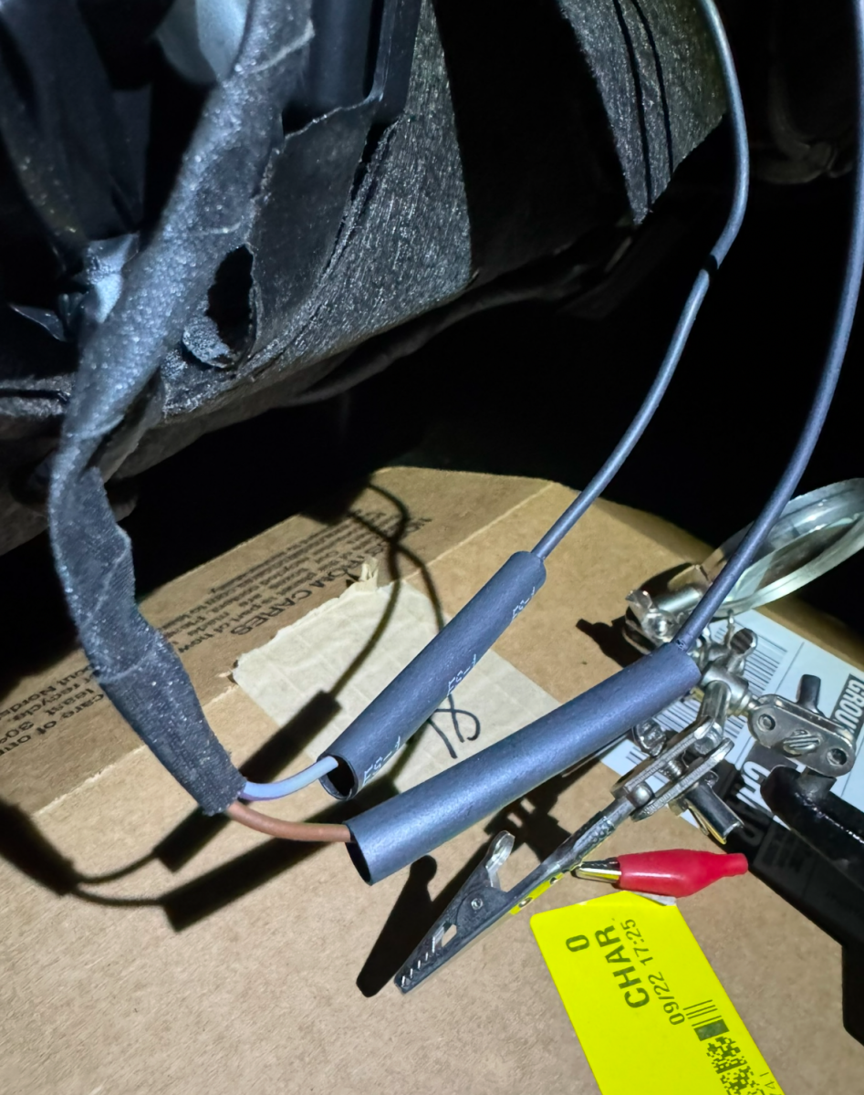

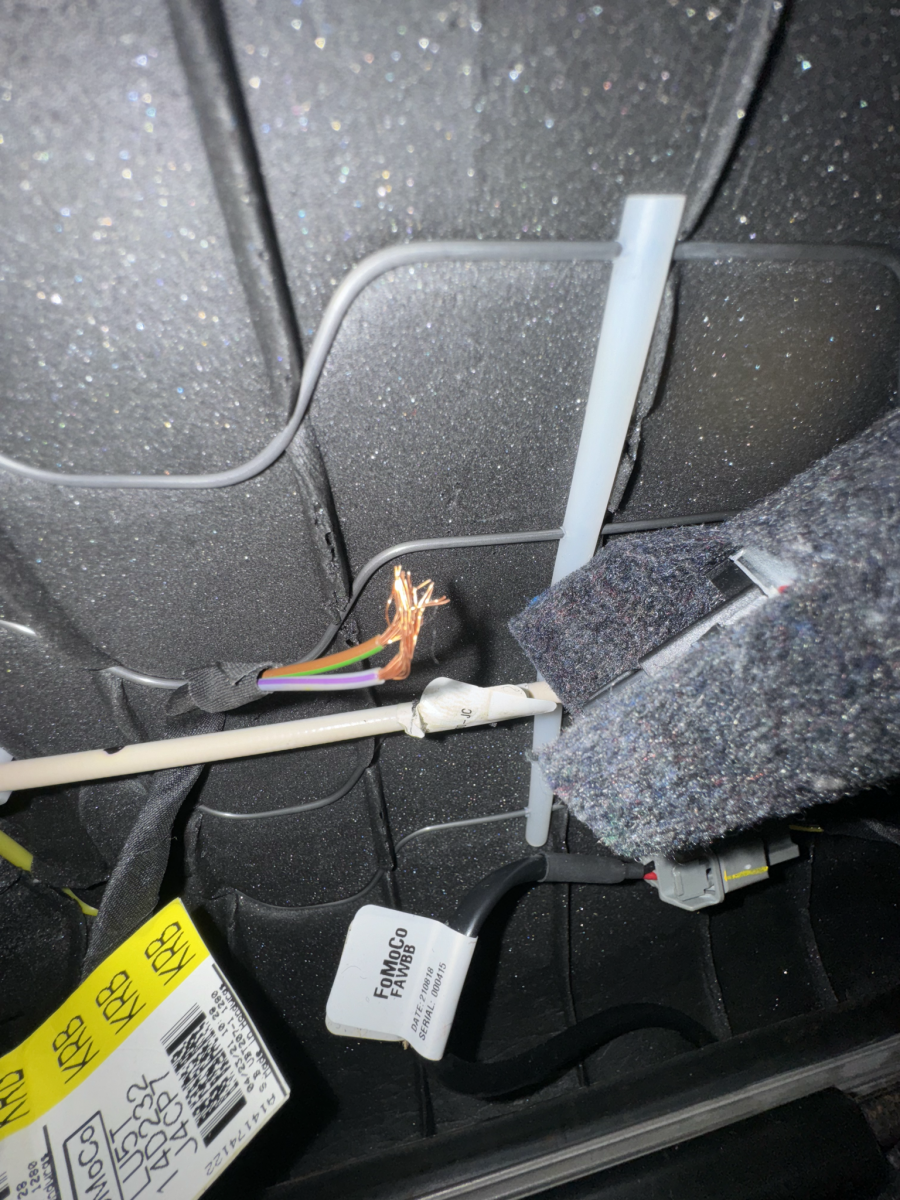

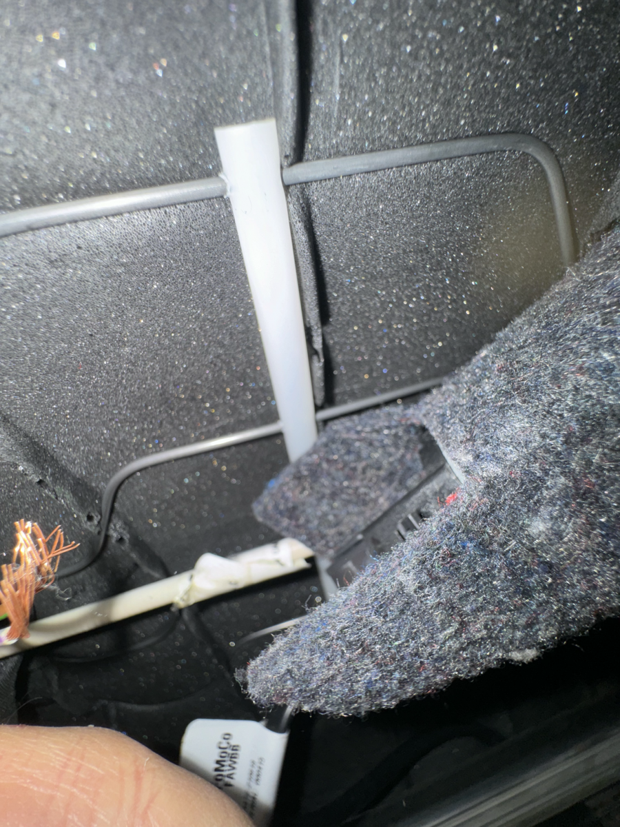

Process:
  1. Stripped the wires on the new connector about .25 to .5 inch
  2. Crimp butt connectors (https://www.harborfreight.com/elect...urpose-stripper-crimper-and-cutter-59714.html)
  3. Remove torx bolts at bottom of seat plastic behind seat
  4. Unhook plastic
  5. Unhook and unvelcro seat backs
  6. Unzip seat back
  7. Remove old connector from lumbar
  10. Move wires out from behind lumbar
  11. Attach new wires to old wires. Gy-VT is top right (top is clip side)
  12. Br-or is left
  14. Crimp new connection
  1. Heat shrink
  2. Tie back and stuff
  3. Reassemble
Enjoy
