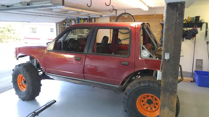

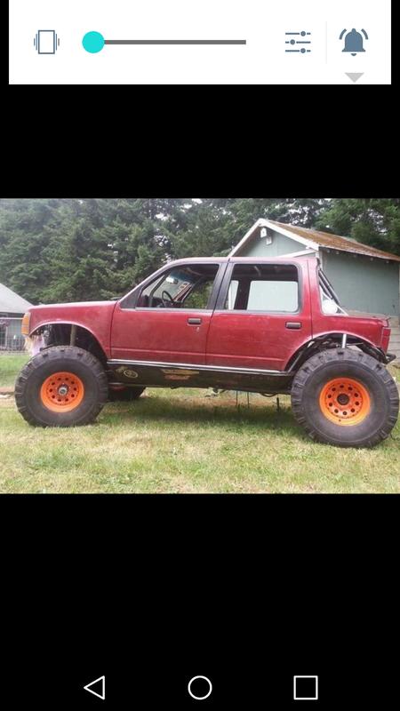

My cousin built this and started to tear it down to redo the tube work and put d60's under it and coilover's. He ended up selling it to me in peices and I put it together as best I could. He had coilovers in front but I needed to get it rolling so I got some air shocks for it. Currently it is 90% done I just need to connect exhaust finish tightening everything and figure out why the Coil pack is smoking.
Front is d44 5.13gears lockrite stock ford radius arm with 2" Dom tube sleeves and a panhard bar.
Rear is 9" 5.38's, full spool, disc brake conversion, trussed.
Engine is stock 4.0I v6 with cai, heddman headers straight piped.
D20 twinstick tcase with front dig option all billet.
Transfecase is c4 all billet with a c5 to adapt to 4.0l.
Art Carr gate shifter.
