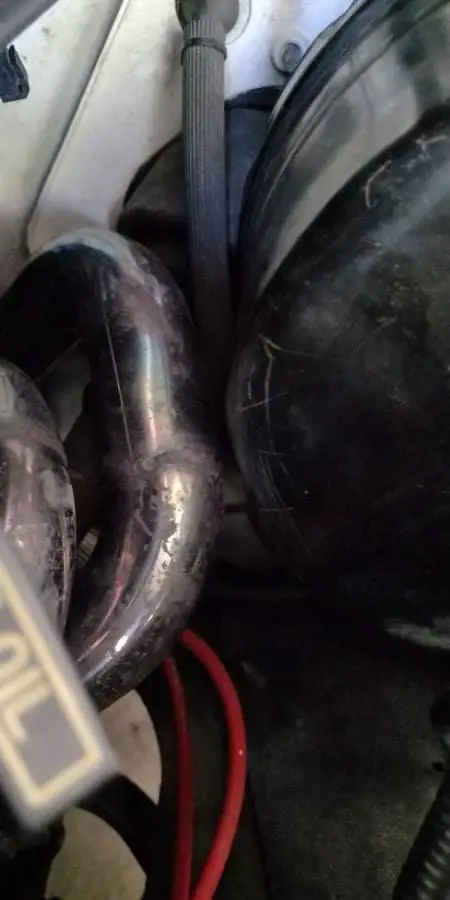

Follow up on this. Motor mounts were replaced but with extra power this header pipe now was vibrating all the time. Modified the brake booster and will see how that goes. 🤷‍♂️

Maybe put some heat protection on that brake booster
Or wrap the pipes
Or wrap the pipes

Yes, definitely needed a massage. From what I can determine, my OBX headers were an earlier made set before they worked out the kinks of their design. Hence this one pipe being much too close to the BB. I've seen later made OBX headers without this problem. But I do not rule out it was a quality control issue on their part either.
I'll talk about the heat protection and perhaps that might be something to do. Thanks for the input!

You can run a smaller booster if needed.... I have used 8" and 9" boosters from a Mustang II on these explorers/rangers to gain more clearance, they have the same boost ability, bolt on, and are much smaller diameter

The massaging of the booster seems to have provided enough clearance so fingers crossed no more issues during aggressive driving.

Thanks for the info about alternative boosters!
