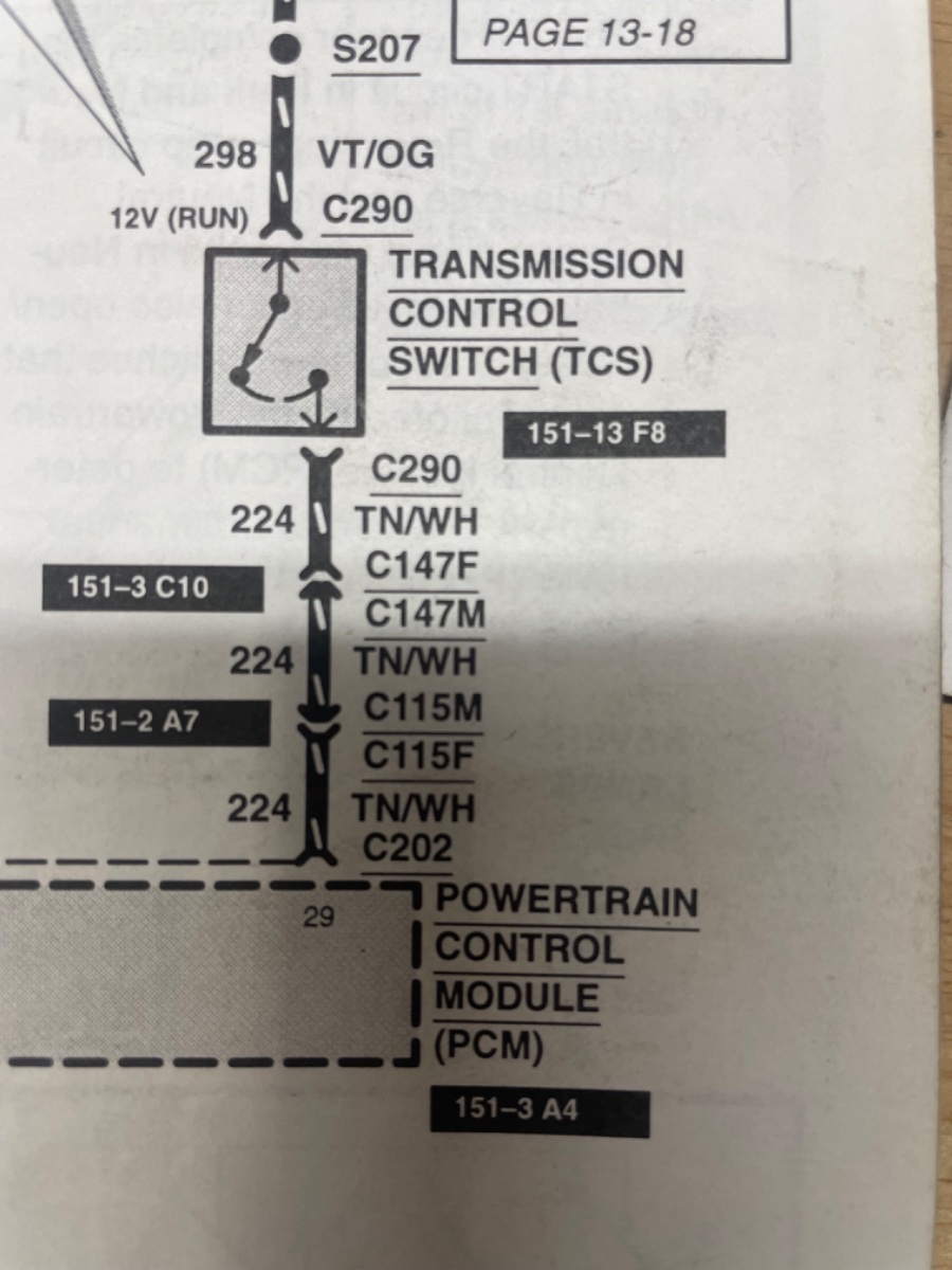

Good morning all,
I've got a '99 5.0 Explorer with the 4R70W trans. Nothing happens when I depress my OD button. Trans shifts fines otherwise. So far I've taken the dash apart, followed the wires down. There's no cut or pinches. I have 12V to the switch and a good switch but still nothing. Does anyone know the location and maybe color wire where it goes into the PCM? Any other thoughts?
