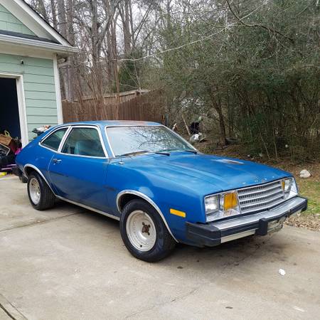

I thought of a badazz swap a few months back, a 4.0 OHV and OD auto and M II 8 inch diffy in to a Pinto. Do y'all think the Pinto is 1400 pounds lighter? Than a 4dr Explorer?
this is available on Craigslist in nw Georgia
It does sound fun tho
I thought of a badazz swap a few months back, a 4.0 and OD auto and M II 8 inch diffy in to a Pinto. Do y'all think the Pinto is 1400 pounds lighter? Than a 4dr Explorer?
What would be the point? Seems like a lot of work for little gain.
