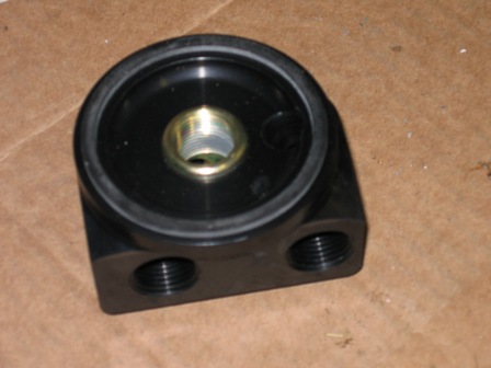

Canton Racing makes a billet aluminum oil filter re-location "puck" that can be rotated 360 degrees, its built for tight clearance area's and is not prone to leaks like the cheaper pock metal block adapters on the market.

Here's my oil filter re-location. Its required for my conversion because the steering box is 1.5" away from teh sie of the block right where the oil filter would normally thread, but you can use these on any Ford engine I believe, contact Canton
as you can see using a remote oil filter mount like this one (with 4 ports) allows you to run the sensor or pressure line for an oil pressure gage, or another filter, or a temp sensor, etc.
I had to make a simple bracket to bolt to the radiator support and hold the oil filter mount. The hoses are trick blue silicoln with simple brass fittings, there is a swivel fitting on one end of each hose, the guys at my local racing shop said this is required if you want leak free operation (body,engine,frame flex)
