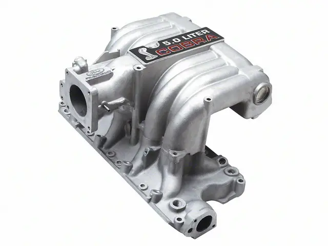

The Cobra intakes are all GT40 intakes, and so is the Explorer, no change(all visual preference).

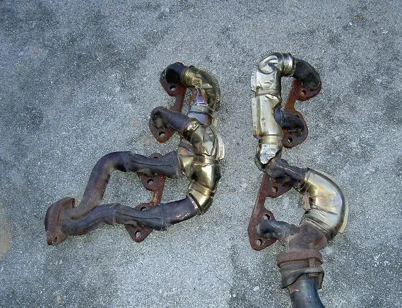

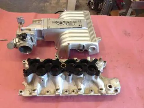

This spacer will add several cu inches of intake manifold volume while keeping heat away from the upper plennum. These things considered, I would think it definitely helps with low end grunt.
Just be sure to acquire the trick flow version as I believe it has the proper length of bolts. You might have to dig around the site here to find information on this.
That looks good, the pieces look like they were made right to fit the lines etc.
You can do the little things like any TB, air inlet pipes, the intakes etc, and the computer will be great with them. Only big changes will upset the PCM enough to need a new tune, like much bigger heads, big cam, or big exhaust changes. Don't change injectors unless you need them, from a very big airflow gain.
The intake spacers help a lot with heat isolation, they add a little low end to the power band by taking a hair off the top end. Be careful with the EGR pipe though, that thing is a certain specific length to fit between the parts. A new spacer will require a different EGR pipe length. Fit those part together loosely without tightening any one bolt. When they are all held by the bolts(none tight), then you snug them and tighten as needed.

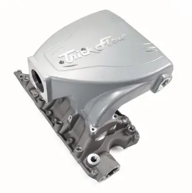

I was talking with a member of a mustang forum and he told me that Trick Flow has a complete top end kit which claims 360HP, with everything shown in the picture WILL PASS SMOG with a proper tune...? I called the tech line but they are closed but asked for a call back. The only thing I don't see on the site or on any of the parts are C.A.R.B #'s I could possibly believe that with the correct tune it would pass emissions but without a C.A.R.B Number it will immediately fail visual ( Unless you get a cool car enthusiast tech who's willing to look past visual as long as the emissions are within their parameters.) I would buy this kit in a second for the Dollar to HP ratio, but I can't afford to disassemble my top end every two years - So with fingers crossed I'm praying TRICK FLOW is going to blow my mind and tell me it has a C.A.R.B # Please God of Horsepower and everything cool for our vehicles fit the first time, come as the correct part number and please most of all cut me a break and help me build power within the guidelines of the state of California.....Amen​
The TFS kit is popular and I'd say in an ideal vehicle it will hit the advertised numbers. Those are gross HP of course.
You have GT40P heads which require unique exhaust manifolds that do not fit normal "non P" heads well(the plug wires will hit). Changing to normal head ports would need the other kind of manifolds, plus an EGR port if that is to be kept.
Unfortunately what you find is based on a great flowing exhaust, like Mustangs typically will have. These 2nd gen Explorers have in stock form less than half the exhaust flow potential of Mustangs people know. That's why these GT40 302's have only about 200rwhp stock, yet in the same 302 Mustang car, they would be closer to 240rwhp(rated, the way they rated factory HP). That's only assuming a 15hp difference between an HO 302 and the GT40 302. The difference is more than that.
To see what you are facing as a power challenge, look at pictures of popular 302 headers for 86-95 Mustangs. Compare those to what you have, pictured above. Now measure the total area of the tailpipes, and the total area exiting the muffler(s).
These Explorers have a ton of choked off horsepower being lost, compared to all other vehicles. The TFS rating is based on a high flowing exhaust, not a single muffler system with exhaust manifold primaries which lead into each other, tiny primaries BTW.
The exhaust is free hp, concentrate on that. I don't mean free in cost, the power is there already and you just need to set it free.
