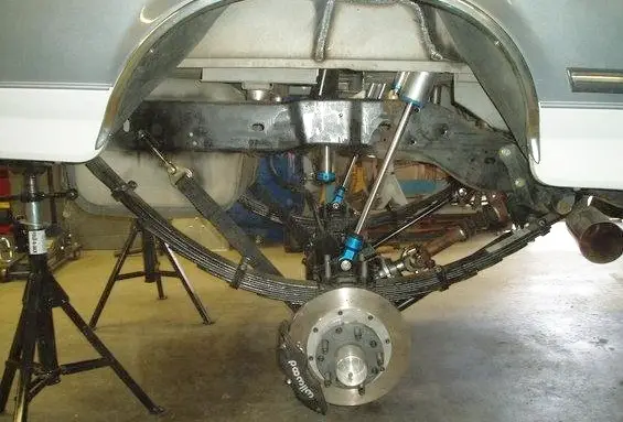

Okay guy's I have ran into what could potentially be a problem! As most of the members in this forum are looking to just eliminate the AWD unit all together I myself have a slightly different plan inline, because of the rear suspension I plan to have in the rear of the Explorer it is going to call for the factory style telescoping driveline. From the figures we have written down we are looking to gain anywhere between 19" to 22" which we are going to limit with limit straps at about 17.5" taking in consideration the stretch of the straps - Here are the spring/shackle package I will be using, and as you can see the telescoping driveline is an absolute must due to the amount of movement these springs actually move! - KEEP IN MIND FRIENDS THIS IS ONLY DROOP! If you look at the picture there is quite a distance between the Axle and the 4" bump stops welded into the frame!
So here is my conundrum after searching the web for a tail shaft conversion kit like the Jeeps have - NOPE! no such a thing, so finally I ran across a site which made a Slip Yoke Eliminator in which you slide their Yoke over the input shaft of your transfer case, then they want you to drill and tap into hardened steel - "which they said it's allot easier then it sounds!" PLUS, PLUS, I HAVENT SAVED THE BEST FOR LAST! They want me to send them my slip yoke, pay in full and the guy I was dealing with never took my name and phone number 0 put me on hold and basically hung up. So Again back to the best part - "THEY WANT $379.00 plus my shipping of my yoke to them and them pay the shipping when the part is ready which get this - EXACT WORDS! " Well um were a little backed up so I don't know could be 6 to 8 weeks." At that point I was so fed up I had to go stretch my legs and try to find another alternative[/LEFT] SO SINCE I NEED THIS PART SO BADLY I HAVE DECIDED TO SEE IF ANY OF MY FRIENDS OUT THERE IN THE EXPLORERFORUM WORLD CAN HELP ME OUT!
So here it is, if any of our amazing members - makes,or know someone who makes them and it a legitimate business - I will keep to my word as long as the manufacturer holds their end up as well. Now if your a machinist - man I must have went to 10 different machine shops who said they could do everything but the grooving inside the slip yoke and this is why I'm so frustrated and I REFUSE TO SPEND $375.00 FOR AN ADAPTER THAT " I MYSELF HAVE TO GO OUT AND BUY A $40-$50 DOLLAR SPECIALIZED SLOW TURN BIT, THEN FURTHERMORE NEED TO FIND THE CORRECT TAPER FOR THE VOLT THEY ARE SO GRACIOUS TO INCLUDE! LOL - I myself am no machinist and don't use SolidWorks or anything but by drilling a hardened piece of who know's what grade material, I would be willing to bet that with all thorq and 4WD driving allot of us do, wouldn't that be compared the weakest link?

I'd ditch the 4406 and go with an early bronco Dana 20. Order a ZF adapter and 1/2" spacer kit from AA.it bolts right up,vss plugs right in,smaller and stronger than a 4406, easy to find,and easy to rebuild.
