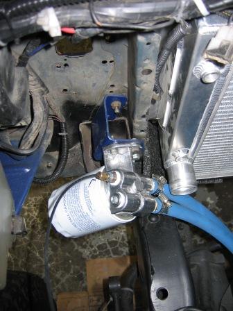

My oil filter location requires me to remove two 8mm bolts for the fender skirt to change the filter, and a funnel is required to keep it off the frame there too.
