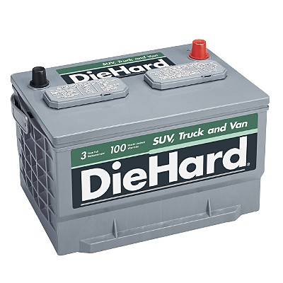

If it were me, I'd just buy a battery that can be replaced by the most abudant store chain. Sears has a few 1000 CCAs which fit in the Explorer. I ran the grey "SUV, Truck and Van" version and my brother had a "Gold North" in his 97 Eddie Bauer. The last one I had died just before the 3 year warranty was up -- no biggie, it was replaced (Sears are like ants here, they are all over the place). It was cranked on a few times by a 9k lbs winch to the point that one battery terminal melted and had to be ghetto repaired in the field.
If you're really worried about getting stuck due to a dead battery, run a dual setup. All batteries will die eventually. But a dual setup pretty much eliminates the chances of you being stuck because, playing the probability numbers, the chances of both batteries dying at once using a good dual battery isolator is very slim.
