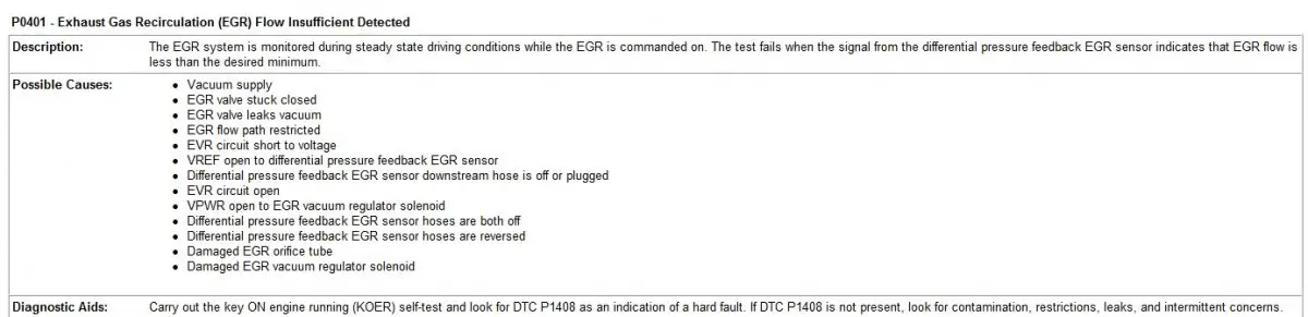

According to Fords Service Information for P0401 for a 2010 Explorer, these are the possible causes.
This is the first pinpoint test for P0401 below. Is this the only code you have now? Do you have a scan tool that will allow you to do a key on engine running test?
I have seen the third to the last possible causes (hoses reversed) that caused a P0401 that was hard to diagnose because all parts were new.
When a situation like happens you fall back on what could have gone wrong.
If the hoses are installed backwards the voltage will go down towards 0 instead of going up towards 4.50 volts like it should.
That would cause a P0401 all day long.
Dont know if that is possible on the ESM type egr valve.

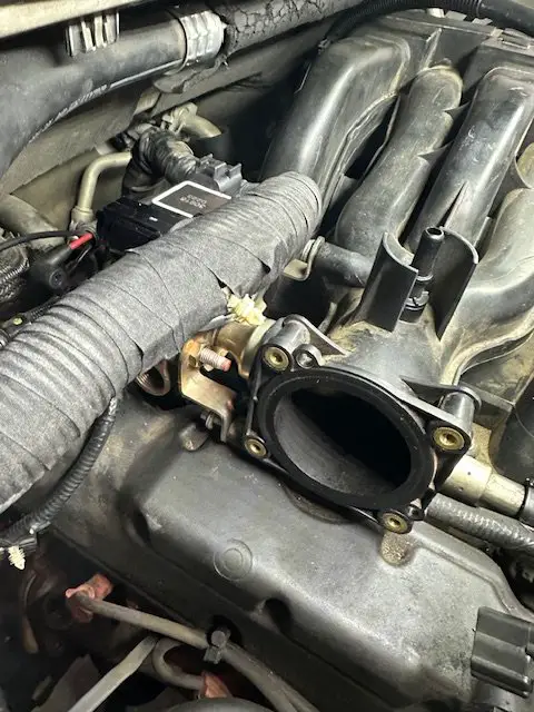

Wait, something isnt right. You said you have an integrated DPFE sensor.
If you do then it also has an integrated EGR solenoid.(but it is listed separately on your list of parts) Can you take a picture of the egr valve and post it here to eliminate any confusion.
I will try to help as best as I can.
